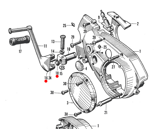

Thanks Lrutt! I think you mean these two parts. I haven't actually looked at it on the bike yet, so I'm not sure if its just a wonky spring that needs replacing or if these two parts are missing altogether. Thanks for the heads up!
malcolmgb
Posts: 401
Post by malcolmgb » Thu May 08, 2014 3:28 pm
I think it's 16 & 24, 18 is a plastic bung.

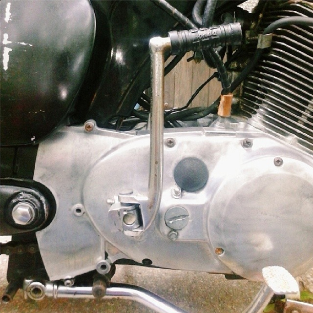

Thanks for the tip. Here's a photo of the kickstart lever back in action. The lever was missing a spring and ball entirely!
Re: Resolved!
Post by LOUD MOUSE » Wed May 14, 2014 6:50 pm
Sorry for the caps!!!!!!!!!!!!!!!!!!!!
I RECOMMEND YOU INDEX THAT LEVER AT 11:00 WHEN FOLDED IN.
WHERE YOU HAVE IT WHEN YOU KICK IT THROUGH YOU WILL HIT THE INTERNAL STOP.
THAT WILL ALLOW YOU TO TWIST THE SPLINE END OFF OR SPLIT THE SHAFT AT THE OIL HOLE AT THE OTHER END.
YOU WILL FIND THAT INDEXED AT 11:00 THE LEVER WILL CONTACT THE FOOT PEG AND THAT IS HOW HONDA MEANT THINGS TO BE. ..........lm
