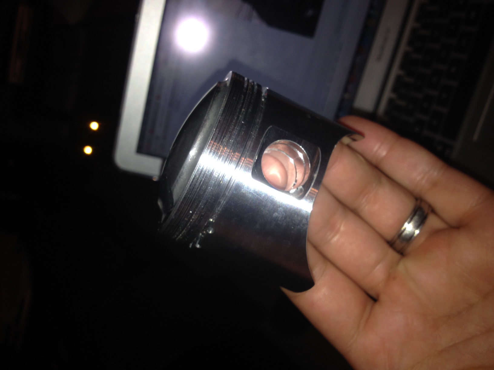

Post by Brickyard » Tue Oct 20, 2015 7:52 pm
Wiseco brand piston kit from classichondarestoration.com

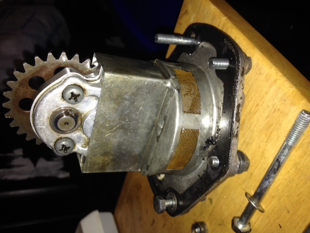

Post by Brickyard » Tue Oct 20, 2015 9:02 pm
Cam roller parts in every crevice...
