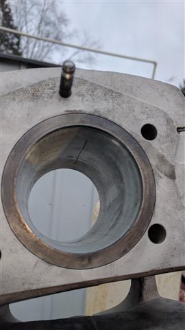

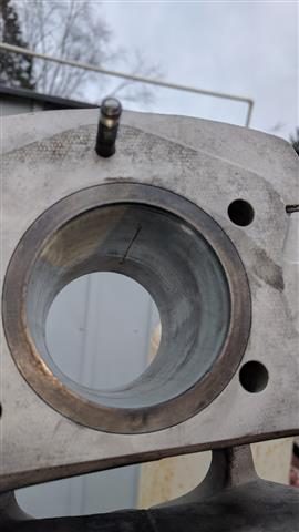

I pulled the end of the vent tube out from the RH case and rode it. lots of oil came out!!
1 remove engine
2. tear engine apart
3. find missing circlip on RH piston and YUUGE gouge in cylinder.
its always simple..
