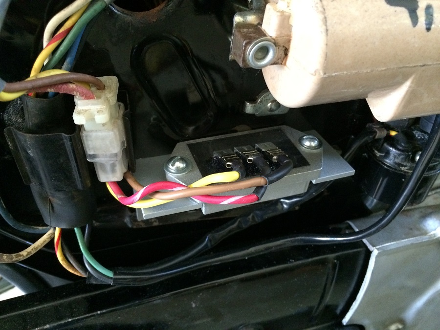

Has anyone made/found a mounting bracket to install a Kohler voltage regulator in a CA78? If so, could you post a photo?

I didn't make a mount for mine. I just used one of the bolt holes from the old rect. bracket location. The regulator works great.

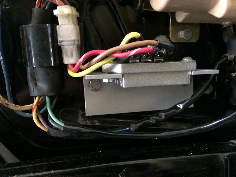

Post by garncarz » Mon May 26, 2014 9:31 am
I made this from a piece of 1 1/2" aluminum el. Seems pretty sturdy.

Post by SWARDLAW » Tue May 27, 2014 7:11 am
I like the looks of that. I'll be back on the milling machine this week to make one for my bike.
