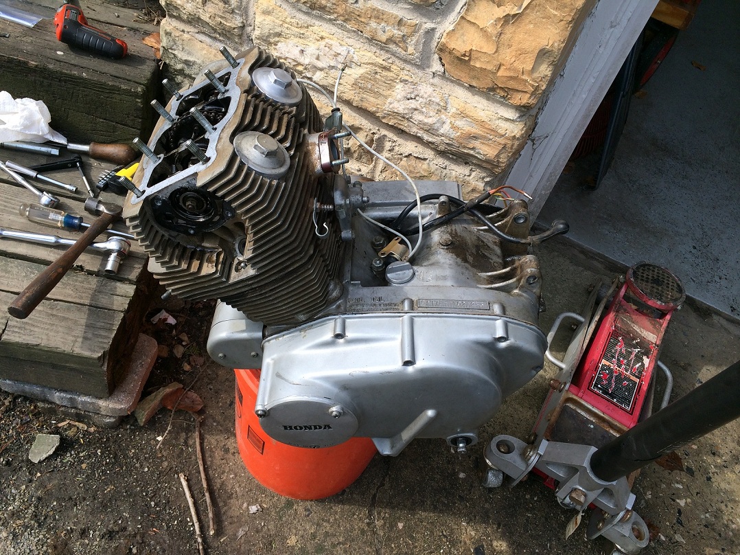

Well, I got up my nerve and dropped the engine yesterday. Everthing looks pretty good inside. I didn't measure them but the cylinder walls are bright and shiney with no scratches. Lots of carbon on the heads and piston tops (soft toothbrush and aircraft paint stripper).
While I am at this point, is there anything I should do before it goes back together? Anything in the pictures look amiss?
Oh, you really want to make sure that you have a firm grip on the cam chain masterlink clip so it doens't fall down into the crank case. Ask me how I know.
