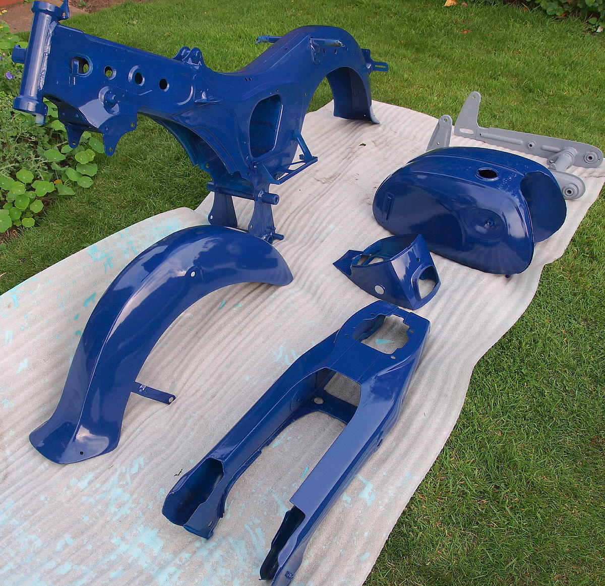

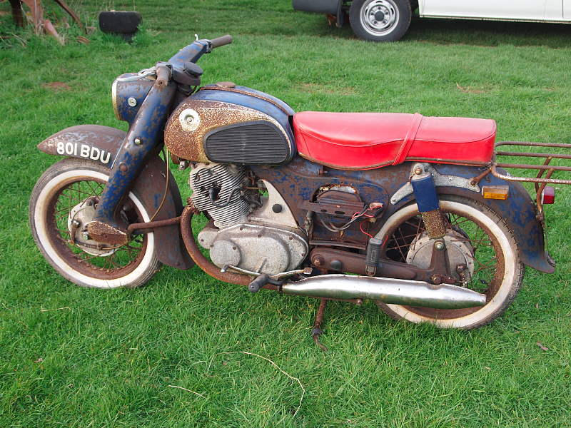

Welcome to the Forum! Please post some pics of your Dream as that must be one of the earliest models in the US. I'm restoring a very rusty 1962 C72 Dream with pressed handlebars and the 'bug-eye' tank panels.
I have been doing the cycle parts while the weather was nice, but we are now into fall so the engine comes next.
As found - very original and very rusty.
Al-fresco paint booth.

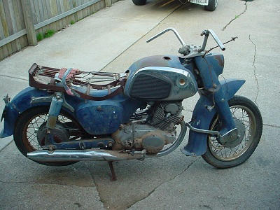

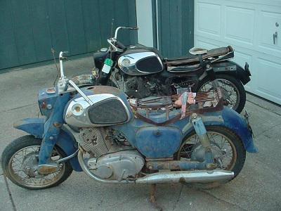

here are photos of the 61 dream, boy it is really an "Ugly Betty" I bought it for parts i needed for an equally ugly 1965 dream but when i found out it was a 61 I thought it was a better idea to fix up the 61. i will be stealing parts from the 65 so it will probably end up as a 62- 3/4.
I just got the bill silver engine manual wow what a great book.
The engine has compression and turns over good, is it worth trying to get it running or will i do more damage to the engine.
I have quite a few parts to shine it up, nos rims, spokes, handle bars and front headlight rim, i will probably check into having some of the other items re-chromed this winter
I am also looking for a front brake hub and tail light among other things the 61 has a smaller diameter hub and a small rectangular taillight.
Keeping busy cleaning up the rust and and tarnished aluminum.
I do have one question for the experts, i have looked in the forums and found different opinions on painting the side cases, were they painted from the factory or polished only.
Thanks Mike

Hi,
Very nice find, you won't see these often in the US.
The dream was delivered in three (and four in the US) colors, black, red and blue. The white dream is strange in Europe, something to do with regulations in that period.
Side cases are painted, not polished. The main cases are not painted.
The '61 did have a plate steer, instead of the tubular steer that is shown on the picture.

Mike
That's a really nice find! As Jensen says - you probably should have the pressed steel (low) handlebars on there. I may have a spare rectangular rear light lens but they are not easy to find and consequently quite expensive.
Are your mufflers stainless? Nice if they are.
It looks very restorable for a bike of that age. I would think that a '61 Dream would be quite rare in the US. In Europe we had indicators and mine came with the (locking) brackets for a tire pump.
Apart from that fender and maybe the handlebars, it doesn't look like you are missing much.
