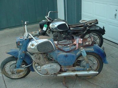

here are photos of the 61 dream, boy it is really an "Ugly Betty" I bought it for parts i needed for an equally ugly 1965 dream but when i found out it was a 61 I thought it was a better idea to fix up the 61. i will be stealing parts from the 65 so it will probably end up as a 62- 3/4.

Very nice find, you won't see these often in the US.
The dream was delivered in three (and four in the US) colors, black, red and blue. The white dream is strange in Europe, something to do with regulations in that period.
Side cases are painted, not polished. The main cases are not painted.
The '61 did have a plate steer, instead of the tubular steer that is shown on the picture.
Jensen

That's a really nice find! As Jensen says - you probably should have the pressed steel (low) handlebars on there. I may have a spare rectangular rear light lens but they are not easy to find and consequently quite expensive.
Are your mufflers stainless? Nice if they are.
It looks very restorable for a bike of that age. I would think that a '61 Dream would be quite rare in the US. In Europe we had indicators and mine came with the (locking) brackets for a tire pump.
Apart from that fender and maybe the handlebars, it doesn't look like you are missing much.
