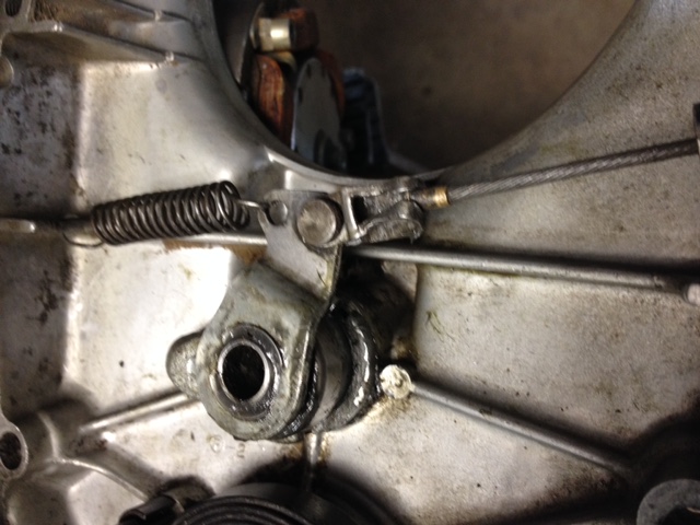

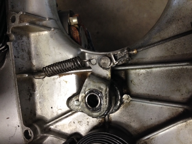

Clutch Adjustment-Stiff Clutch
Never posted pics here. But gonna try.
They seem to have come out as attachments. That work?

Re: Clutch Adjustment-Stiff Clutch
Doesn't look like the OEM springs I have. ....................lm

Look at the angle between the cable and the release arm in the picture, it's past 90°. That means, to release the clutch you have to pull hard enough to pull things into almost a straight line. Back off the cable adjustment until the cable and the arm form a 90° angle with the clutch lever pulled all the way to the grip. Then turn the center adjuster to take up most of the free-play. Adjusted this way, you will have maximum mechanical advantage to release the clutch.
