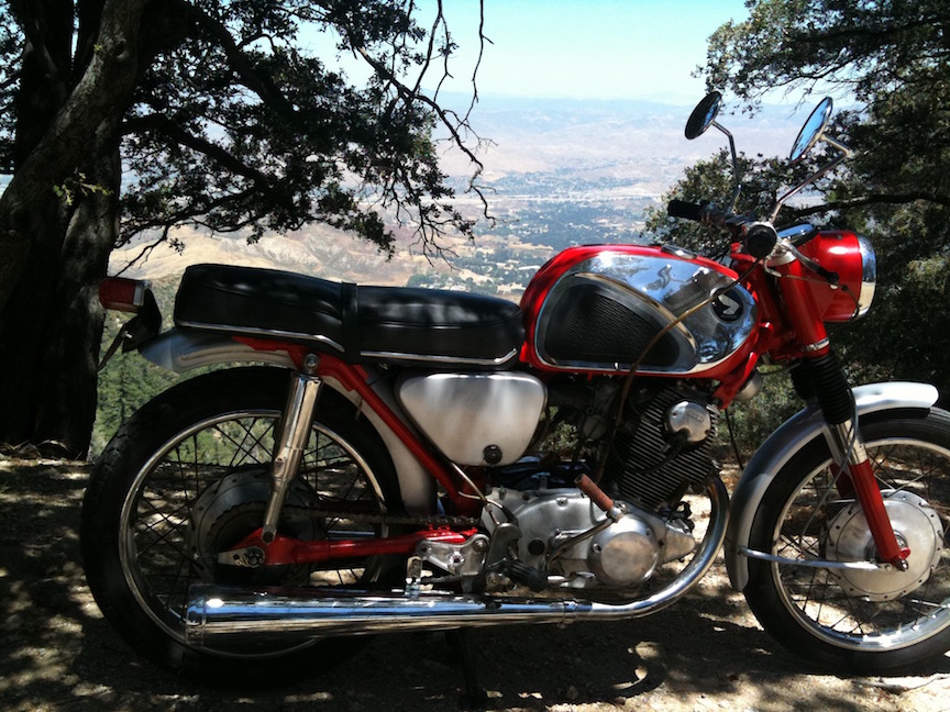

    This is NOT the correct clutch cable routing. I use it to get the maximum bend radius for the cable, and it seems to reduce the effort a bit. I put a loop in a coat hanger wire to hold the cable to the carb mount stud so it would not flop around.
    As I said, not the correct routing, but it works for me. In fact, you may notice several non-standard items on this bike, but in its defense it does get ridden!
    Larry
