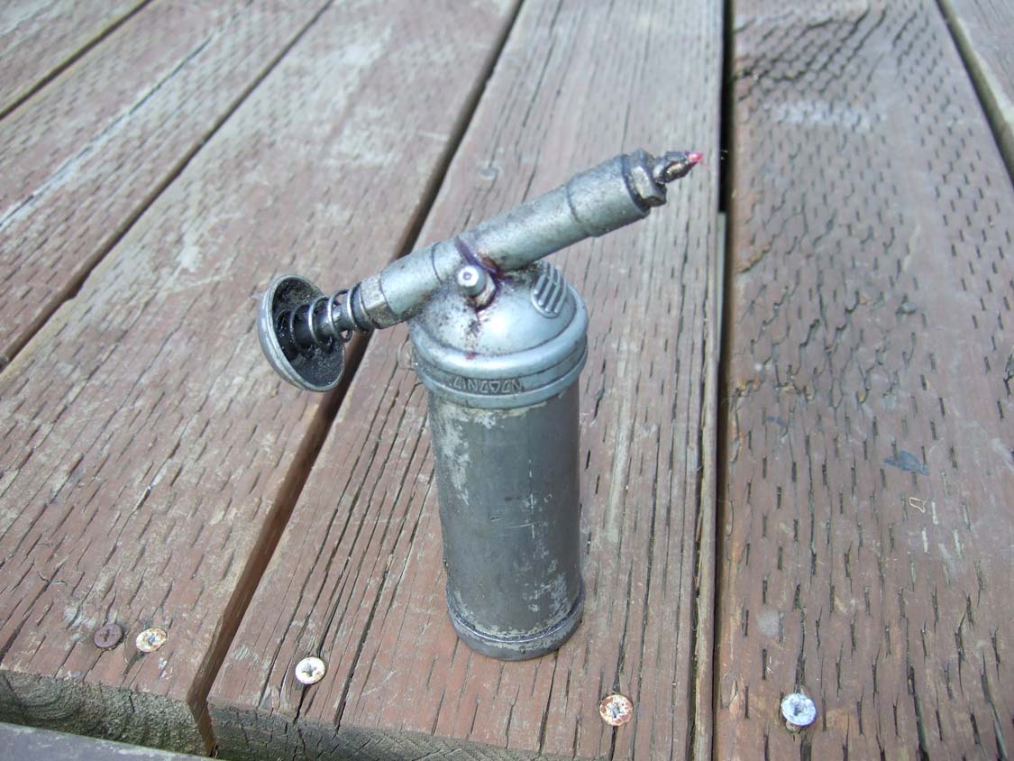

Actually, mine is a Lincoln, looks just about the same as the Dualco. I drilled and tapped a 1/4 inch thread in the top for a grease fitting, I fill it with my big grease gun, no mess and no air bubbles.carabener wrote: The Dualco's are ok, look nice, expensive, and a pain in the a-- to load with grease and pressurize-(get working).

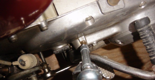

The Texas made dualco is pictured below at work on a CB77 if you get one be sure to get directions with it, or call the factory and they will happily send you them.
