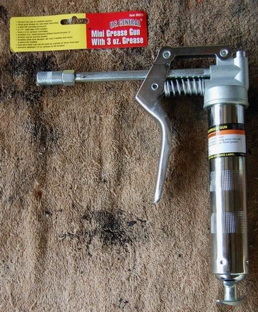

Cheap from Harbor Freight, do they have this store in Canada?
It fit small fittings on my bike until I used it on regular size zerks, then it didn't...so now I have two.
grease gun2.JPG (57.29 KiB) Viewed 4515 times
