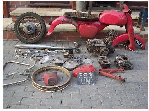

I am working on honda C77 1961 press bar , I have attach some pictures
Well see another week how is going , I will let you know , hope it is ok ..
http://farm3.staticflickr.com/2851/1115 ... 06bd_b.jpg
http://farm4.staticflickr.com/3798/1115 ... 128c_c.jpg
http://farm3.staticflickr.com/2811/1115 ... e3aa_z.jpg
http://farm4.staticflickr.com/3707/1115 ... 1427_b.jpg

That was an entertaining video! That fella had an interesting idea on unsticking that engine. I'm hardly an expert, but looking at the photos of your engine suggests to me that you probably have a LOT of corrosion inside of your engine, if the outside is any indication. I gathered from the video that the method suggested in it would work on a "mildly" stuck engine, with clean cylinder bores. An engine with badly corroded internals might need to be torn down and repaired before that engine would turn over.

Just take the engine out and start stripping it, it isn't going to run in its present state anyway.
