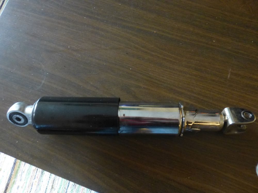

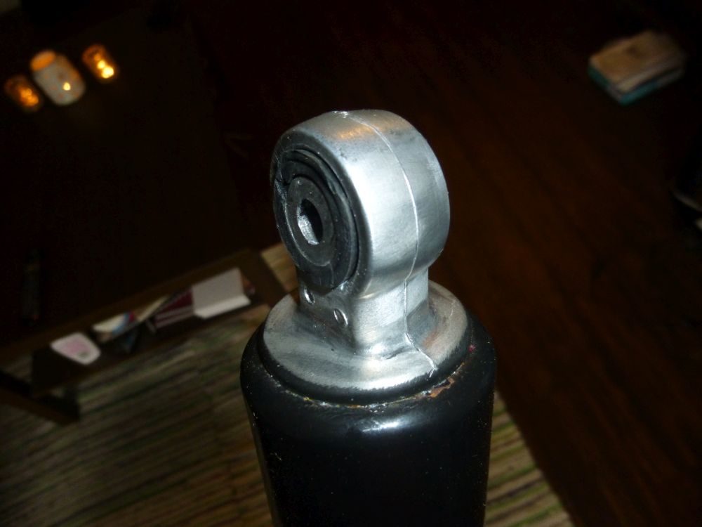

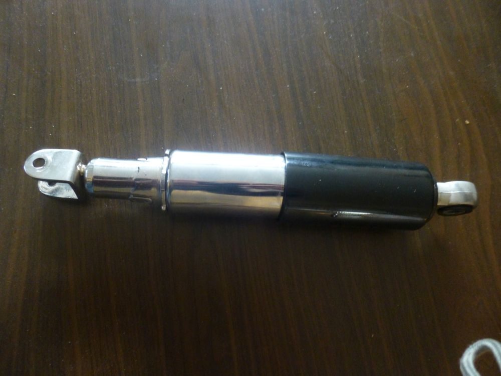

Hi All.,
I had bought a set of rear shocks from Thailand when I rebuilt my Scrambler. It wasn`t a good decision, after 1500 miles they are in pretty bad condition and developed this annoying squeaking noise. Does anyone here have any experience with these shocks? It looks identical to the original but can`t be dismantled the same way. Thanks for any ideas.

G-Man,
Thanks for your reply. I`m afraid I wasn`t clear when I described my issue. I can`t even disassemble the shocks. As you know well, the original version comes apart if you compress the spring and remove the closing end as two halves. On other types (not Honda) there is a pin that you have to pop out and the shock comes apart. In this one, there is nothing like this, and the closing end is one unit.
I think I`m just gonna rebuild the original Honda shocks. I learnt from one of your threads that you can buy the covers as new for a Girling that with a little modification can be adapted to the genuine Honda. So, basically you already solved my problem :) I wish I had seen that earlier, then I wouldn`t have bought this poor quality Thai replica.
