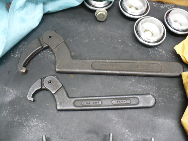

Steve,
I have 2 jointed hook spanners. I used the smaller one on the nut. The copper pipe trick was born out of necessity. A few years ago I was using a wood wedge and it finally gave out. I had a piece of copper on the bench from a plumbing project and the light bulb came on.
Hill, only need to use the stock head gasket, good for STD- S4.
HT
