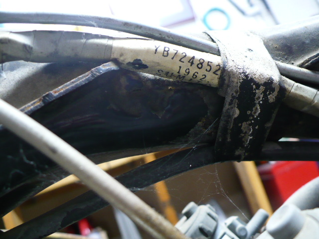

Harness tag
Harness tag

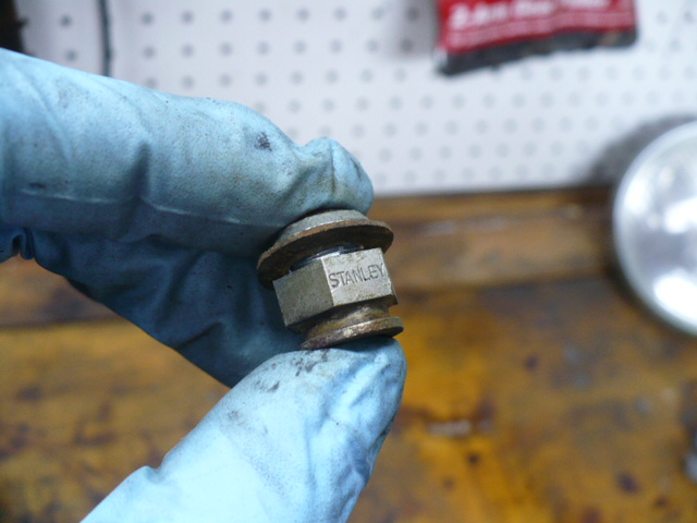

I started disassembly with the headlight bucket. I never paid much attention to the other Super hawks I have worked on, but I noticed the neutral light assy had Stanley punched into the fixing nut, which is metal, not plastic.

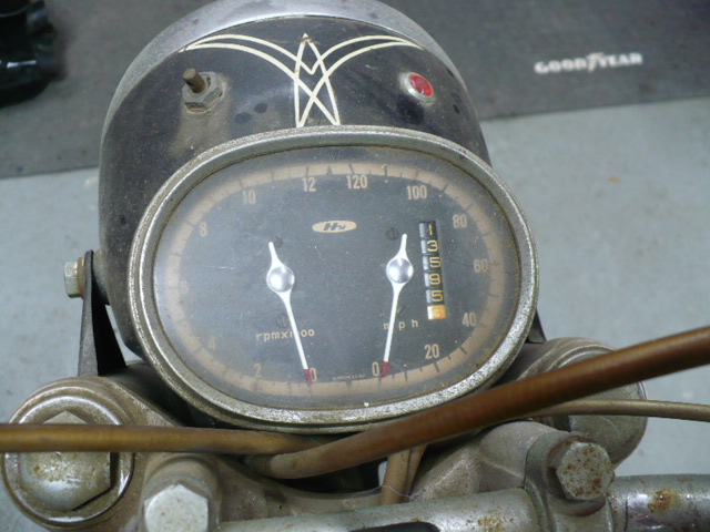

Speedo
Speedo

Cool, keep the details coming. I'm no expert on the years, but I've gathered that the 62 has the most unique parts out of all of them. Should be interesting.

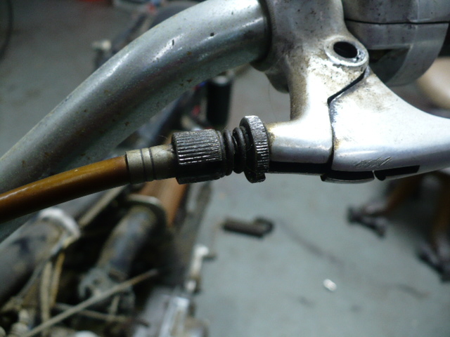

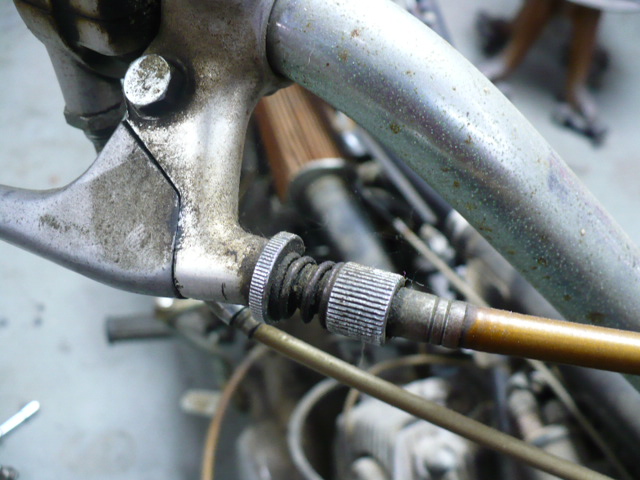

Thanks, my mistake and I fixed it. I'll keep the pictures coming. My cable adjusters have springs as shown. I have seen springs with star adjusters on the early CA77s I've had, but not with the small, round lock like mine. Is mine supposed to have the spring?
HT
left adjuster
left adjuster
right adjuster
right adjuster
Post by LOUD MOUSE » Mon Jan 31, 2011 10:46 am
Nope. ........lm
