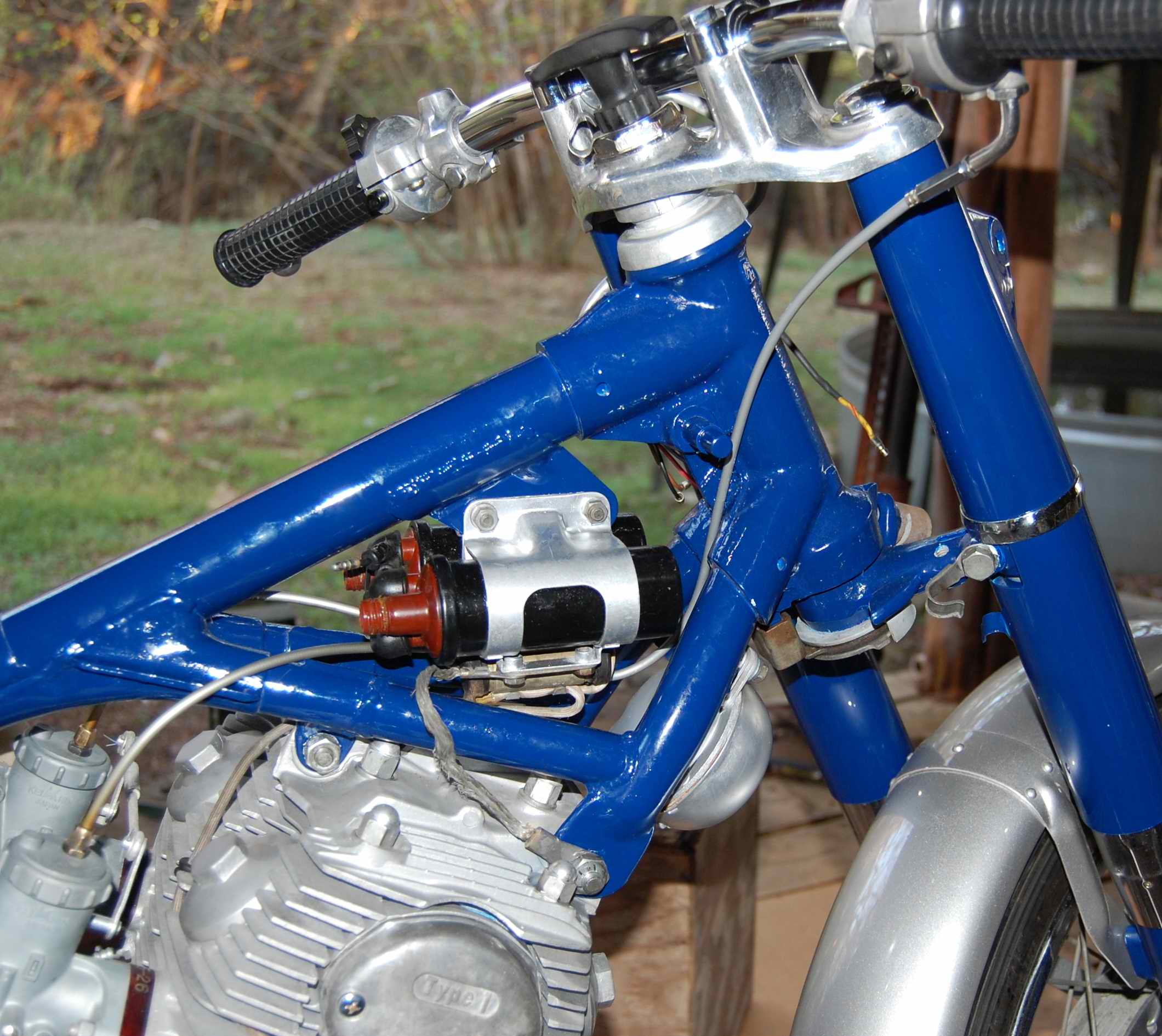

Jleeweb ... where does your ground strap connect? The upper motor mount to ... ???
Dana
1966/7 CB-77 Red of course
Goodysnap
Posts: 456
Location: Lansing , Michigan
Post by Goodysnap » Sun Apr 17, 2011 7:33 am
That ground strap is on the condensor mounting bolt.

ground strap
Post by jleewebb » Sun Apr 17, 2011 8:31 am
here it is...sanded off paint on bracket and frame at attachment points, used a dab of dielectric grease to assure a good ground.
note the incorrect throttle cable routing.
