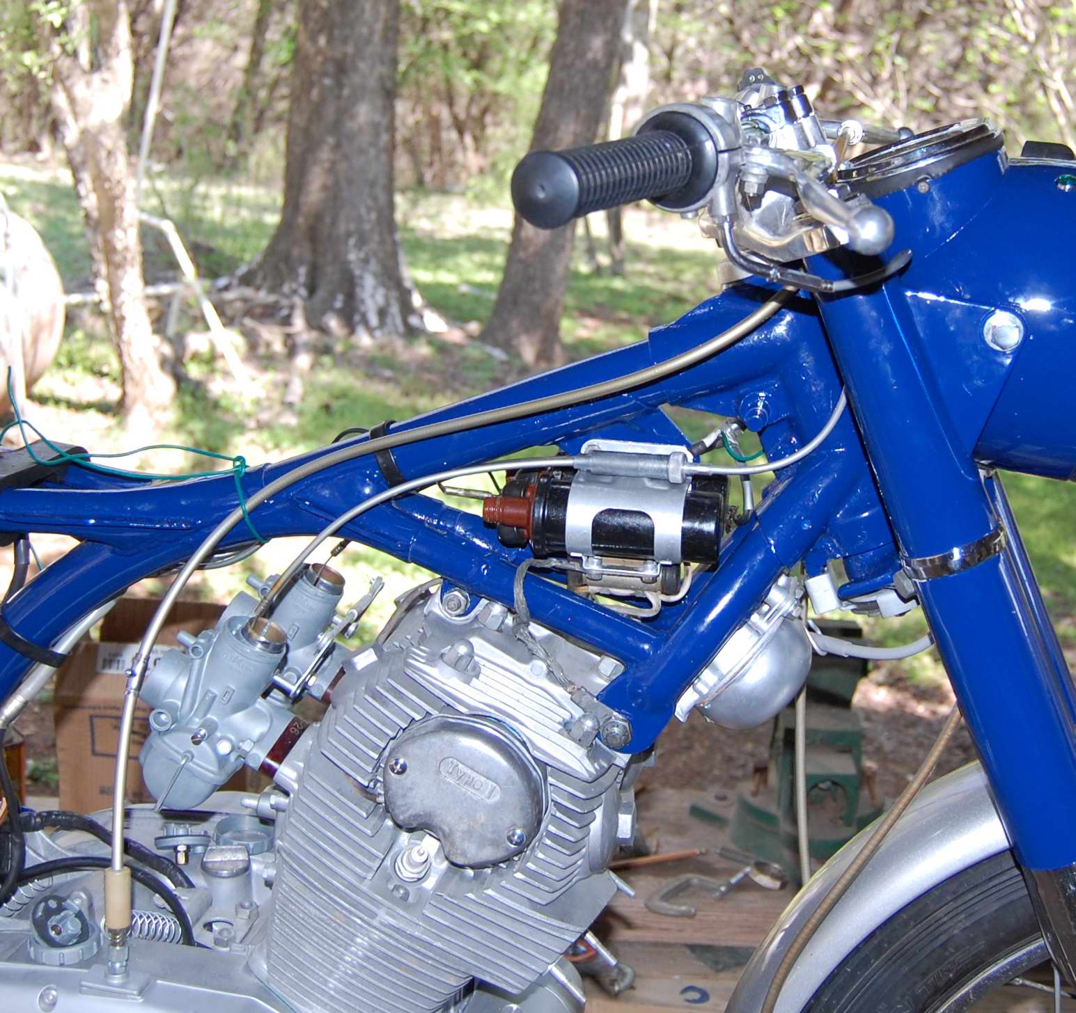

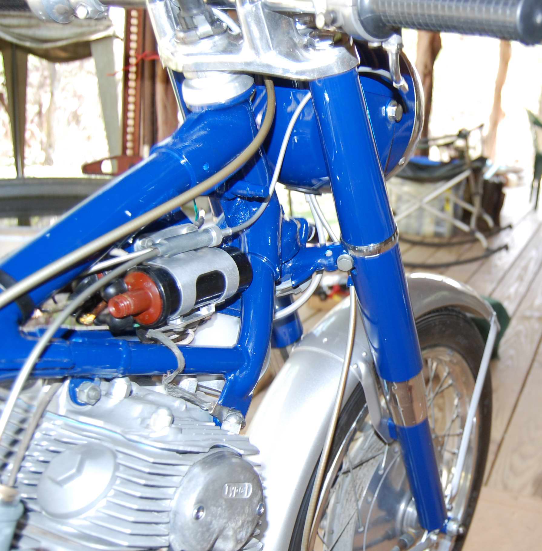

couple of pics...
'62 CB77. "It's a rider."

Hi Jleewebb,
Excelent pics! I don't have mine routed that way, definitely. So I will probably gain enough to make it work well. It's good the seat and tank come off so easily on these bikes!
Thanks for the good fotos!

Post by jleewebb » Sat Apr 09, 2011 10:28 pm
I notice Steve's directions have cable routed over the front gas tank support...maybe try it both ways and see which is best for you...
