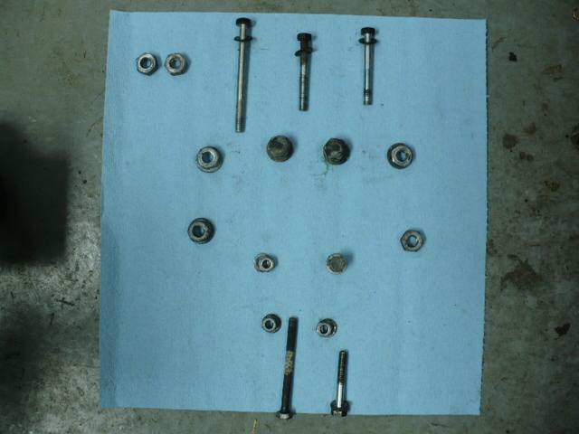

Here is the nuts and bolts laid out. The 2 top side nuts are off on the top left of the towel. The second photo shows the bottom case half for approximate orientation.

Post by LOUD MOUSE » Tue Mar 01, 2011 10:22 pm
I hit the 2 studs in the top/middle case with the nuts Topped Off as it is force in the middle and never has a chance to damage the Case Surfaces. ........lm
Hoosier Tom wrote:Now it's time to split the cases. This is no time to be impatient and ham-fisted. I like to use a utility knife blade that I gingerly tap around the cases with. I have a small finishing hammer I tap with. Then I use a scraper that I have filed/sharpened so it slides in easier and I can pry with it when I get to the thicker part of the blade. There are 2 locating dowels, one in the middle front and one in the middle rear. I have another scraper that I use so I can pry 2 different ares at the same time. I also have a rubber mallet I use if gentle persuasion is needed. Remember, be patient and try not to damage the case mating surfaces.
