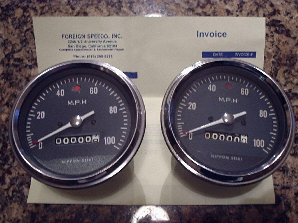

Preston called today (12/19) and the total repair cost with return shipping is $203 for both units which included the required parts. He will ship today and I should have both speedometers within the week. I emailed Bill Silver this week and he mentioned he saw my speedo's in the repair line at Foreign Speedo, Inc. and it should be soon, so I was expecting the call. This experience has taught me one thing, I will never purchase another 40+ year old speedometer unless it has been rebuilt. I will post again when I get the speedo's and see how they work. More to follow. G

That is a good price

Well its Christmas morning and when I go outside to get my paper guess what Santa left on the front porch. Yep, you guessed it, a pair of beautifully rebuilt and looking like new CL77 Speedometers. Just what I needed! Hopefully the mounting rings I saved will work again and I'll be riding before the day is out, Oh wait, its only 30 degrees outside.
I will conclude by saying Preston did a super job for me and I will have absolutely no problem recommending his workmanship to any member of this forum.
I would like to wish everyone a Merry Christmas and a Happy New Year. Gordon
