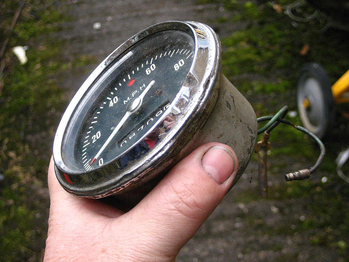

That looks like a truly nice job they did there. When I got my CL77, the speedo had already been part dismantled and the bezel was in poor shape, partly from the dismantling process and patly because the brake or clutch cable had rubbed on it.

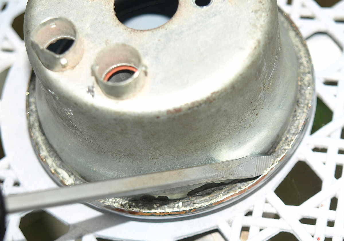

I managed to buy a set of three non-working speedos on ebay with various ailments but two had good bezels, so I set about dismantling one as carefully as I could. I found that the bezel could be prized away from the speedo body (see below) with minimum damage using succesively larger flat-bladed screwdrivers to turn the edge over.

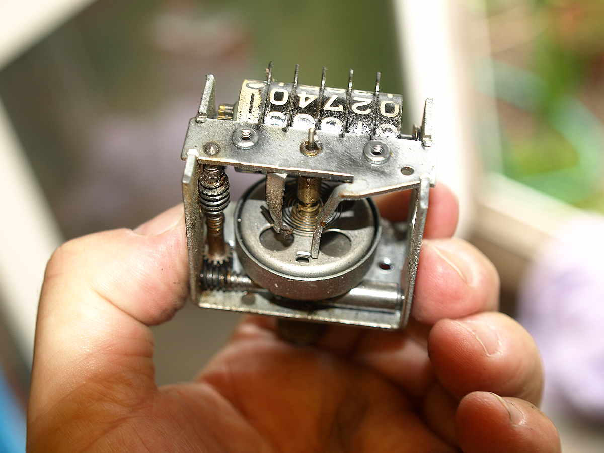

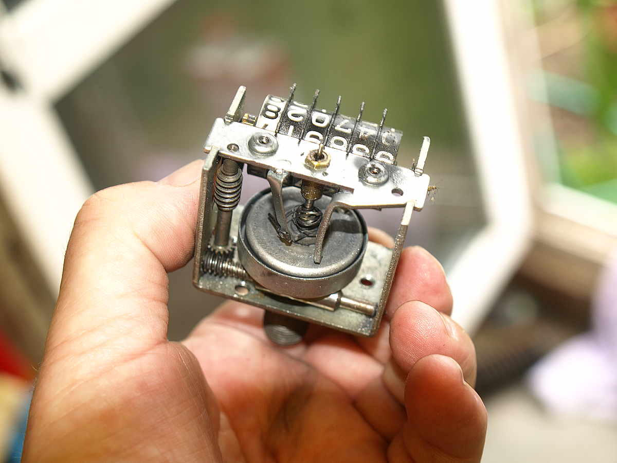

Once I had my movement working to my satisfaction - I took at look at my two spare movements. One had clearly been driven into 'frenzy mode' as described above - the hairspring, which retains the needle against the turning force of the magnet had clearly been in distress and got tangled up as you can see in the pic below.
I think I can repair this movement and get it working, if I can find a new spring. My Father-in-Law repairs clocks so I'll check with him.
There's not much to these speedo movements compared with the old Smith's Chronometric which were full of tiny gears. Next to the spring in the picture(s) you can see the only 'tweakable' items which look like they could affect the calibration. One looks like it sets the zero point and the other changes the spring tension (pre-load). I'll have a play on the lathe and see if I can work out how easy it is to set / re-set the calibration.

Once you're happy you can gently fold the bezel back over the speedo case.

My speedo with bad bezel, in need of TLC
Remove the bezel with flat screwdriver, slowly and carefully.
Movement with good spring.
Bad spring - note the two tweakable stops next to the spring.
