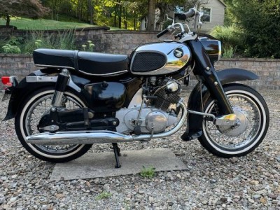

Hello, I'm looking for information on which spark plugs to use. I have what Mr Honda say's is probably a 1967 Dream survivor in mint condition. Any information would be helpful and appreciated.
Serial Numbers
Frame - CA78-1034066
Engine - CA77E-1034128
1967 Honda 305 Dream

1965 CA77 Owner's Manual calls for NGK D6HW spark plugs. Today, the closest match would be NGK D6HA.
NGK D8HA (colder) plugs are spec'd for CL and CB 305s. Would likely be OK for CA77 too.

What a nice looking Dream, Royster!
Please add it to the Dream Registry www.honda305.com/dream/registry
On spark plugs, I would only add that if you find yourself testing various crossover numbers, be sure that the plug itself is the 'non resistor' type. On these early bikes (and not only on Honda) the cap offers the resistance and a resistor plug in series would degrade the spark.
