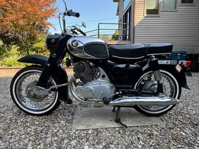

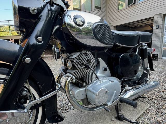

Hello, I'm looking for information on which spark plugs to use. I have what Mr Honda say's is probably a 1967 Dream survivor in mint condition. Any information would be helpful and appreciated.
Serial Numbers
Frame - CA78-1034066
Engine - CA77E-1034128
1967 Honda 305 Dream

What a nice looking Dream, Royster!
Please add it to the Dream Registry www.honda305.com/dream/registry
