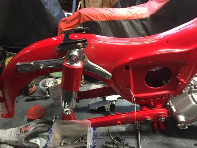

Post by Geoff Hastings » Fri Jun 25, 2021 1:11 pm
Just started the laborious process of flatting and compounding the paintwork now it’s had a week or so to harden off. Two pack would be quicker but I don’t have the facilities so it has to be the old fashioned way. I did find I’d missed a few coats just on one side of the swinging arm so had to respray that again. Not a big deal but that will now need a few days to harden off too. I’ve just hung a few bits on the frame to remind myself what it should look like and spur me on to build up the rear shocks. I’m pleased with my final choice of colour, it was nearly Yellow!

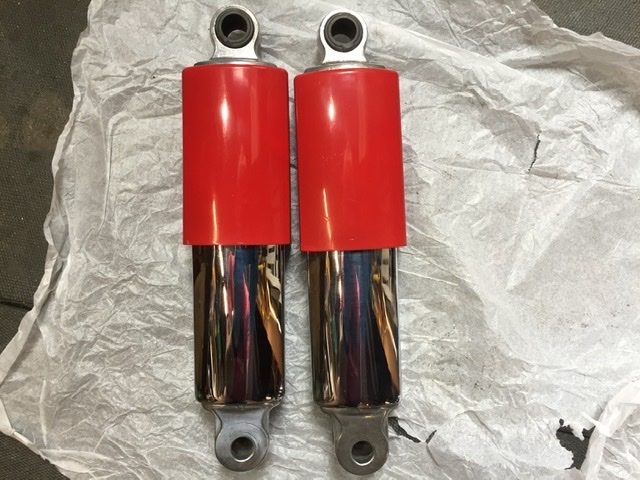

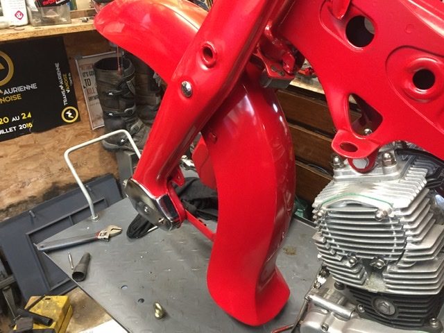

Post by Geoff Hastings » Sat Jun 26, 2021 11:17 am
Rear shocks rebuilt, the homemade spring compressor works well. I had to respray the front mudguard as I went through to the primer along the edge, amateur mistake.

Post by Geoff Hastings » Tue Jun 29, 2021 10:42 am
Finally got the use of my ramp back so it feels like I made some progress today.
