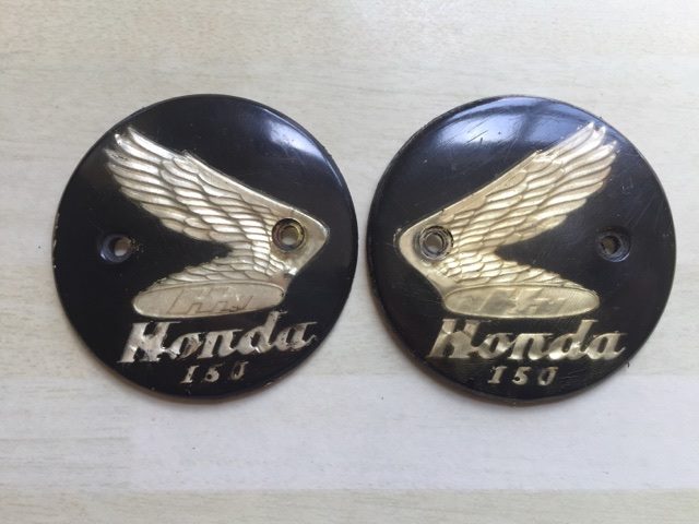

As I started to get all the bits together before reassembling the bike I found the tank badges needed replacing. I checked all the usual sites and couldn’t find a suitable replacement, in fact, I did find a pair of original badges with what the seller described as a couple of cracks. One badge was broken in half and he wanted $95 plus shipping. I decided my badges weren’t that bad after all so set about removing the black paint and what remained of the original silver. Most this just picked off with the fine pointed scalpel, I then painted all the black areas and while the paint was still tacky laid the badge on some cooking foil, this I gently pushed into wing detail and then trimmed off the surplus. They’re not perfect but the second came out a little better as I used a wooden cocktail stick point the apply paint to the very fine detail areas. These will do until I come across something better.

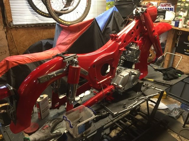

Post by Geoff Hastings » Sat Jun 26, 2021 11:17 am
Rear shocks rebuilt, the homemade spring compressor works well. I had to respray the front mudguard as I went through to the primer along the edge, amateur mistake.

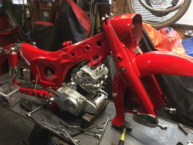

Post by Geoff Hastings » Tue Jun 29, 2021 10:42 am
Finally got the use of my ramp back so it feels like I made some progress today.
