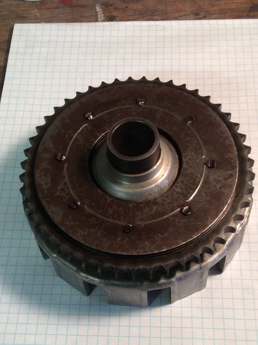

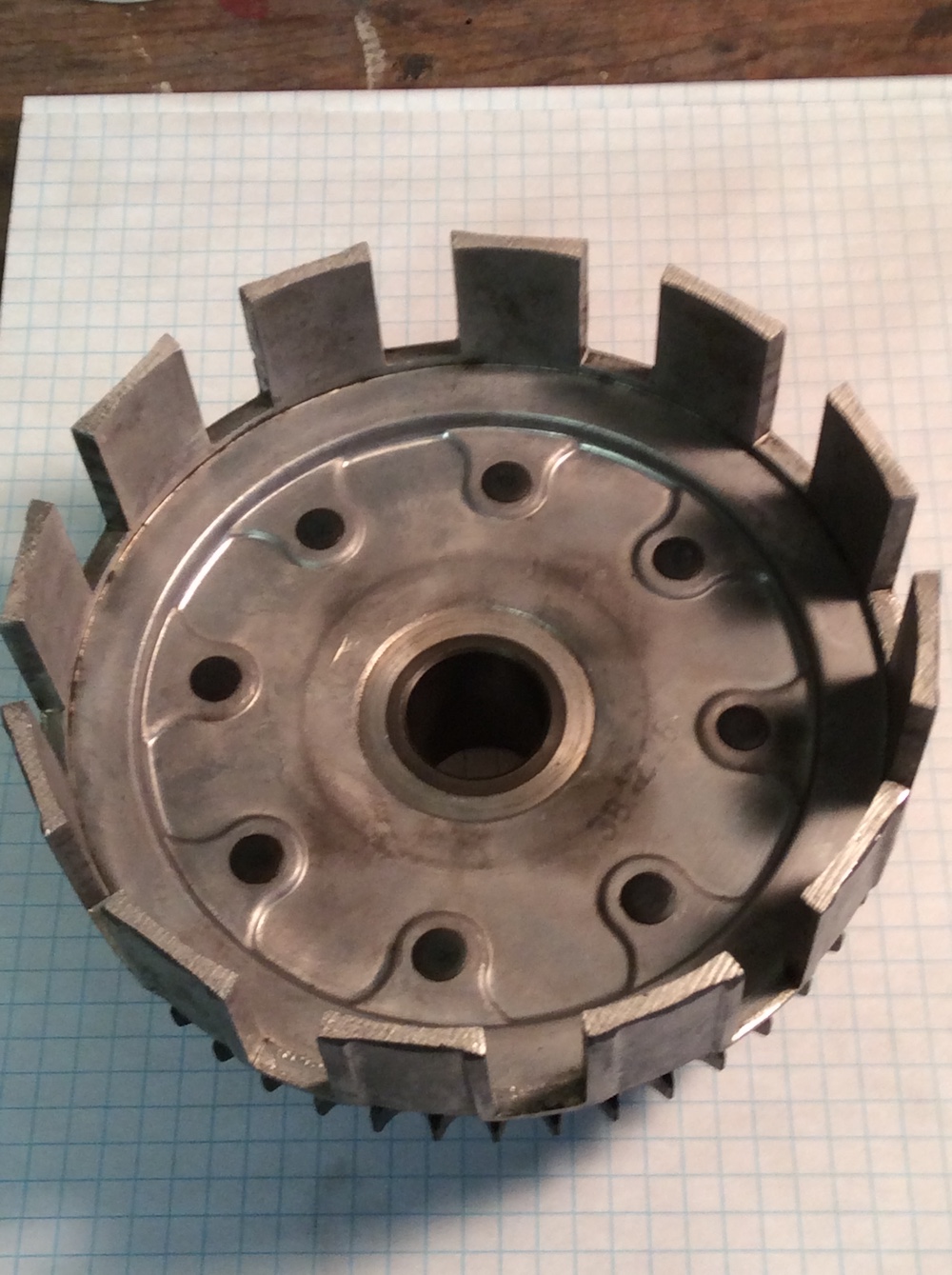

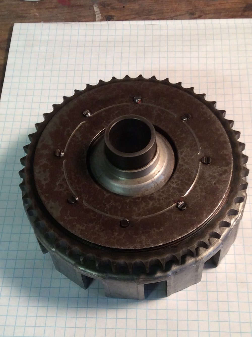

Below are the photos of my clutch basket that you requested.

I continue to work on the transmission and have reassembled the secondary shaft with new parts. There's still a bit of slop in the primary shaft and 2nd gear doesn't engage as well as I'd like. I'll be taking the shift drum out soon to have a good look at it. The shift forks look quite good.

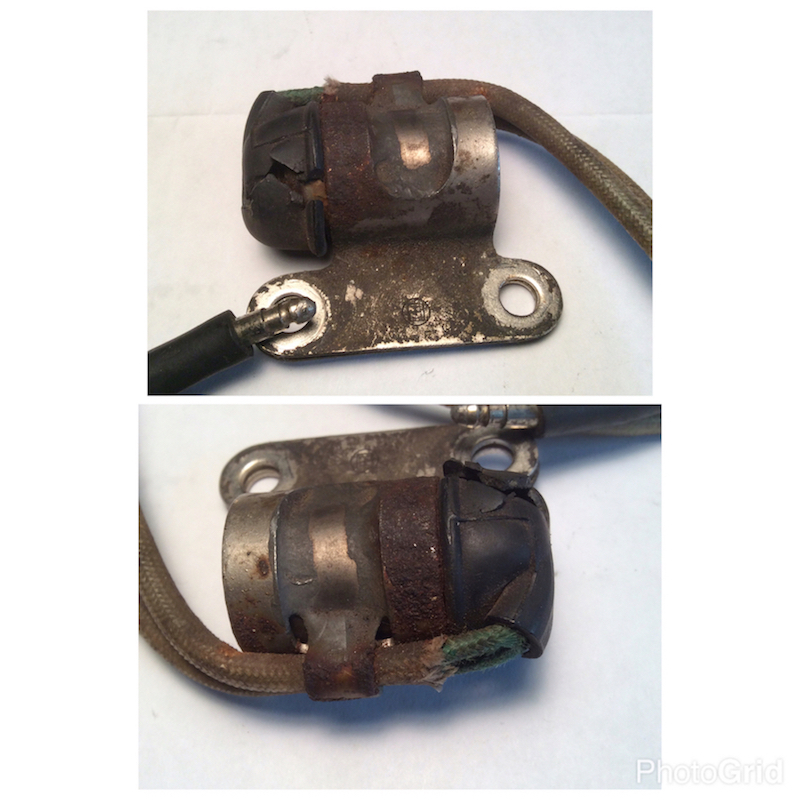

I'm looking at all of the bits needed to get the engine going again and find that, after testing, my condenser is shot. I looked for a replacement, but am a bit baffled by the parts list. There are quite a few listed for my engine serial number range, but looking at available photos of those, they don't seem to match what I have. I would think that any condenser would do, but I'll have to do more research. I suspect mine is part #30250-259-013, but might also be #30250-259-033, 30250-259-014 or 30250-259-034. If anyone has any insight, please share.

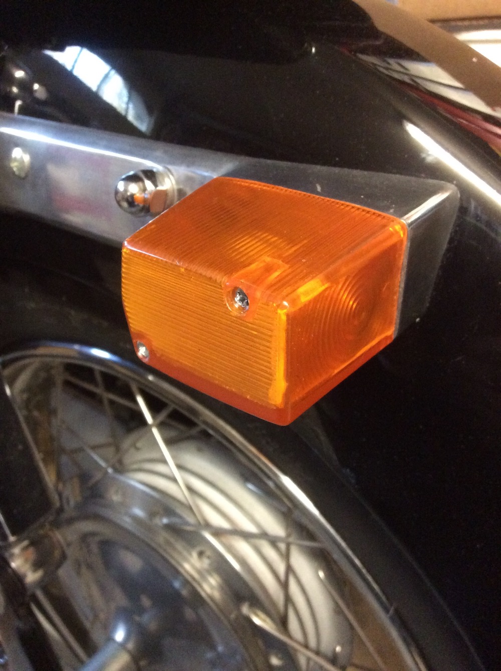

I managed to find a NOS condenser and a few other small parts to continue working. Received new screws for the rear winkers and, along with home-made gaskets, finished that project up.
