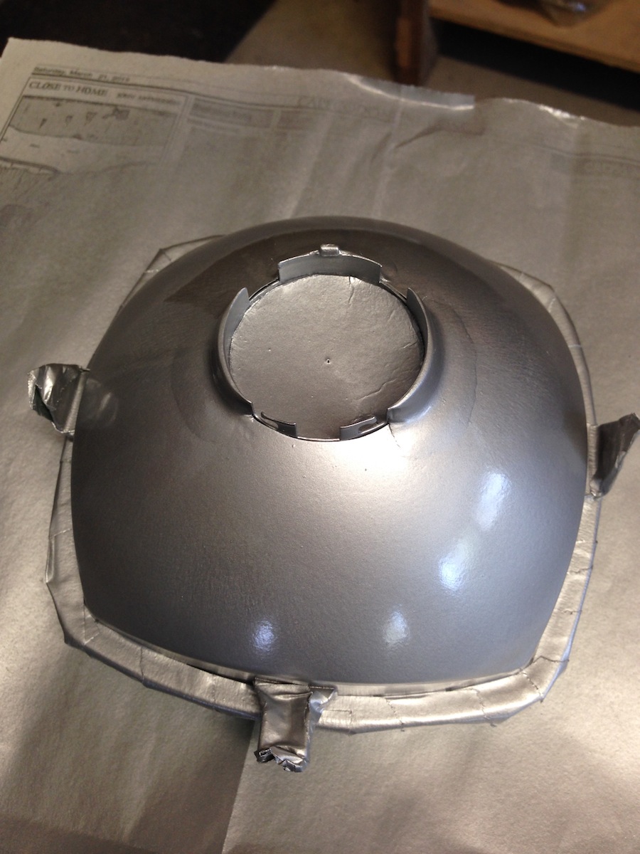

The headlight is almost ready for paint. I'll have to get something heat resistant.
A little clean-up, then paint
Posts: 1273
Location: Cape Cod, MA
Post by Seadog » Mon Mar 23, 2015 11:53 am
Done. 3 coats of heat resistant primer and 3 top coat. Not perfect, but ok.

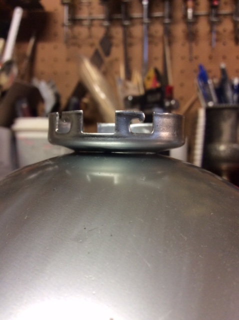

I'm pretty much done with this project now. I had to make a new wire bail for the bulb, since the original wasn't bent in a way that held the bulb in place for this application. I also bought an LED bulb and bent the tabs for fit into the headlight bucket. After a long search, I finally found the .375" wide female spade connectors locally and soldered them to the existing wires. I tested the light with a battery and all is well.

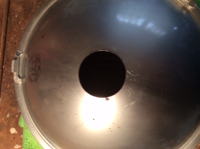

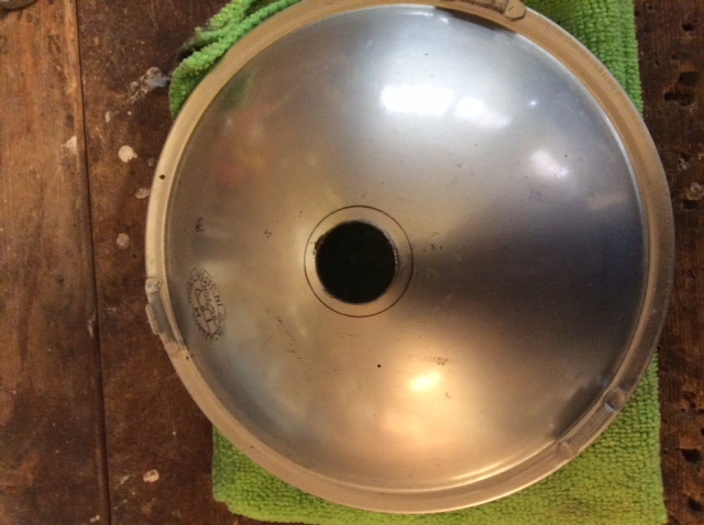

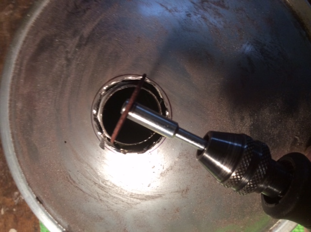

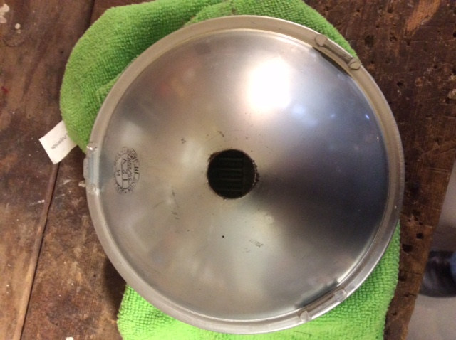

Post by Seadog » Mon Nov 09, 2015 4:47 pm
I thought I'd try to convert a CB77 headlight….
How the bulb holder will sit.
Hole refined.
Hole refined.
Rough hole cut.
Rough hole cut.
Marked for hole enlargement.
Bulb removed
Bulb removed

Post by Seadog » Mon Nov 09, 2015 4:55 pm

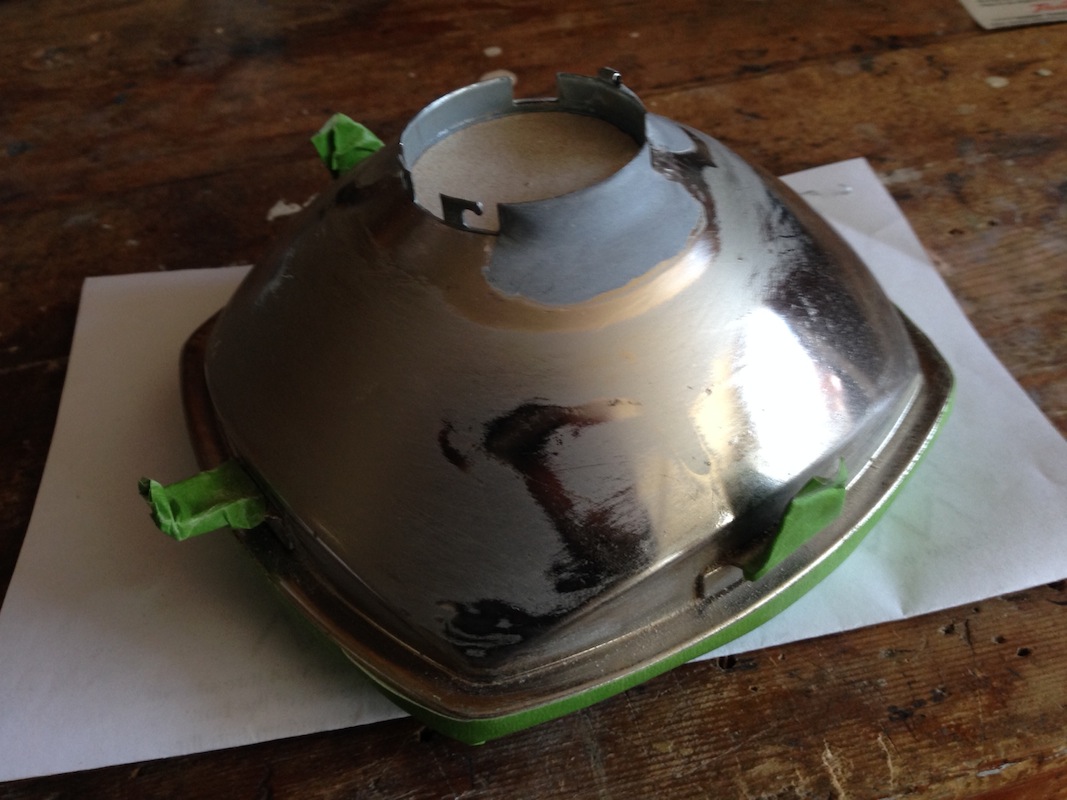

Continued.
Installed.  I'm waiting for an LED bulb.
Painted.
Painted.
JB Weld shaped and sanded.I wish I was able to feather the edge of JB Weld like I can Bondo.  The edge just crumbles.
JB Weld applied and rough shaped with a dental tool.  I drilled 3 ⅛" holes in the bulb holder and forced JB through for greater holding power.
