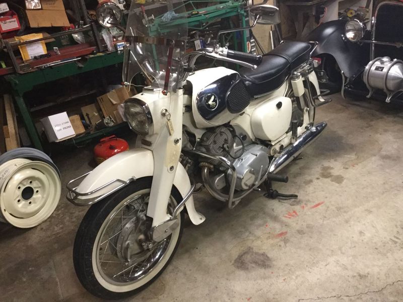

DJM's mention of Honda's longevity got me thinking....how many miles could you get out of a 305 motor if reasonably taken care of? 10,000? 15,000? 20,000? i ask because my 1966 305 Dream that i bought in 1973 now has 10,500 miles. it seams to start and run great , uses no oil and makes no funny noises,clutch/transmission shifts fine, but in my mind i'm thinking it's half worn out? i am 67 now and i probably will not wear it out in my lifetime
