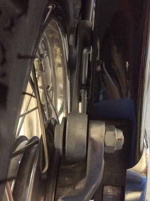

As I was messing about this morning, I noticed that I had not tightened down the front brake stay. Something doesn't look quite right there, so I've posted a photo in hope that someone might comment. Is the stay the right side out? The bolt that secures it to the front fork doesn't seem to engage the nut enough.
Front Brake Stay.jpg (352.71 KiB) Viewed 3224 times

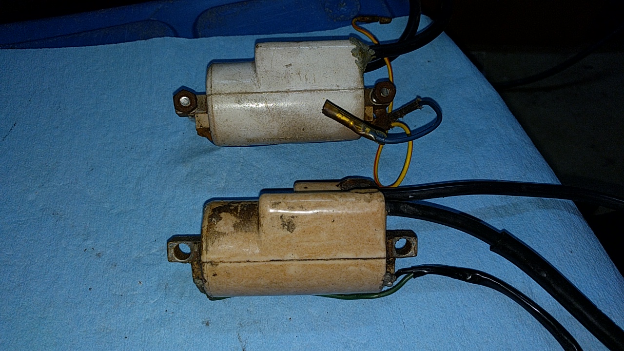

Hi. If I may chime in. I had to replace my coil and discovered that a mid 70's Kawasaki 400 had the identical coil. The wires were a different length so I had to replace them but the coil was fine. Hope this helps you in your search. Regards, Jeff.

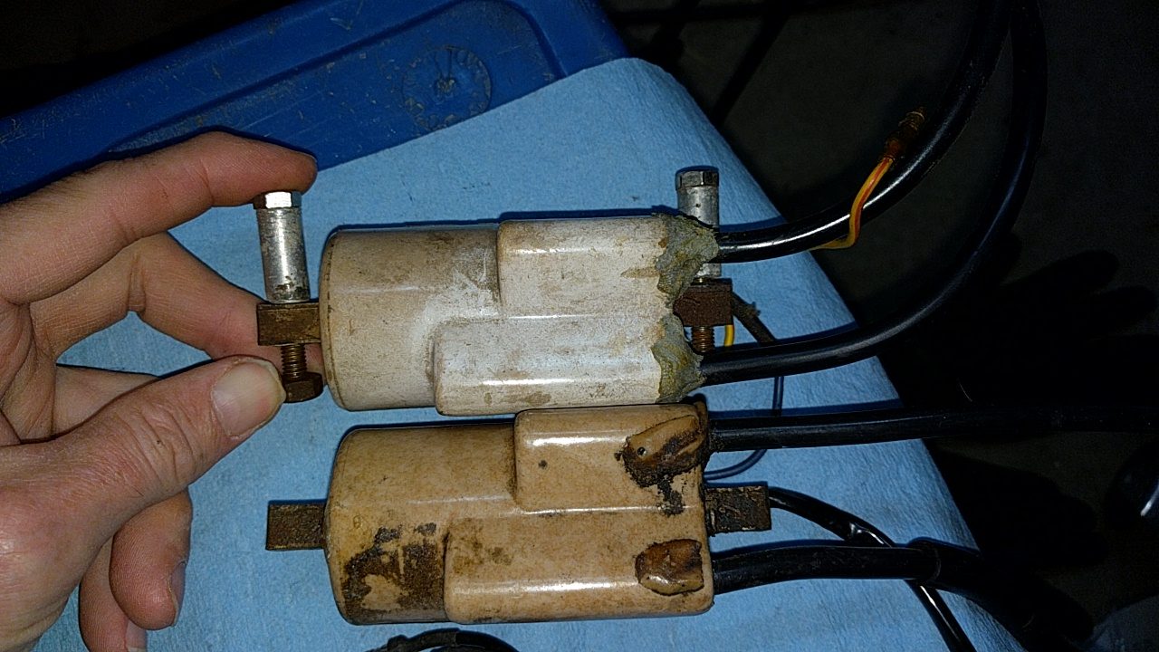

Thanks for that alternative coil information. I have lots of work to do before the engine is ready to start and I'm in no hurry, but I think I'm going to try the one I have. If it fails, I'll look closely at the one you've mentioned. Did it fit the Honda bracket? Most of the after market coils I've looked at had 90mm between the mounting holes. My stock unit has 120mm and I really would like to use the stock bracket. Any idea what the primary resistance is?

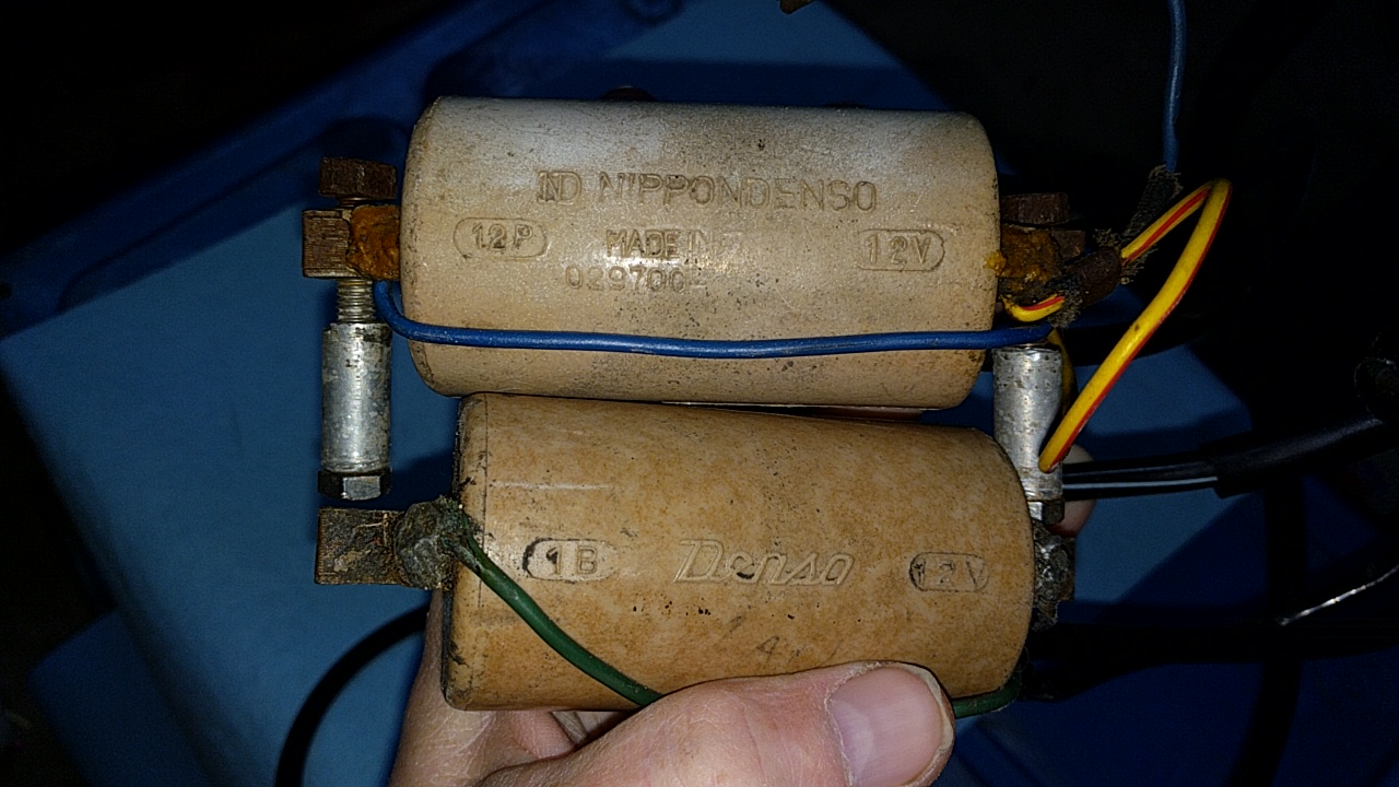

Well, I still happen to have my old coil so here it is beside the one from the Kawasaki (1974 I think): The Honda is the caramel colour and the beige belonged to the kawi.
