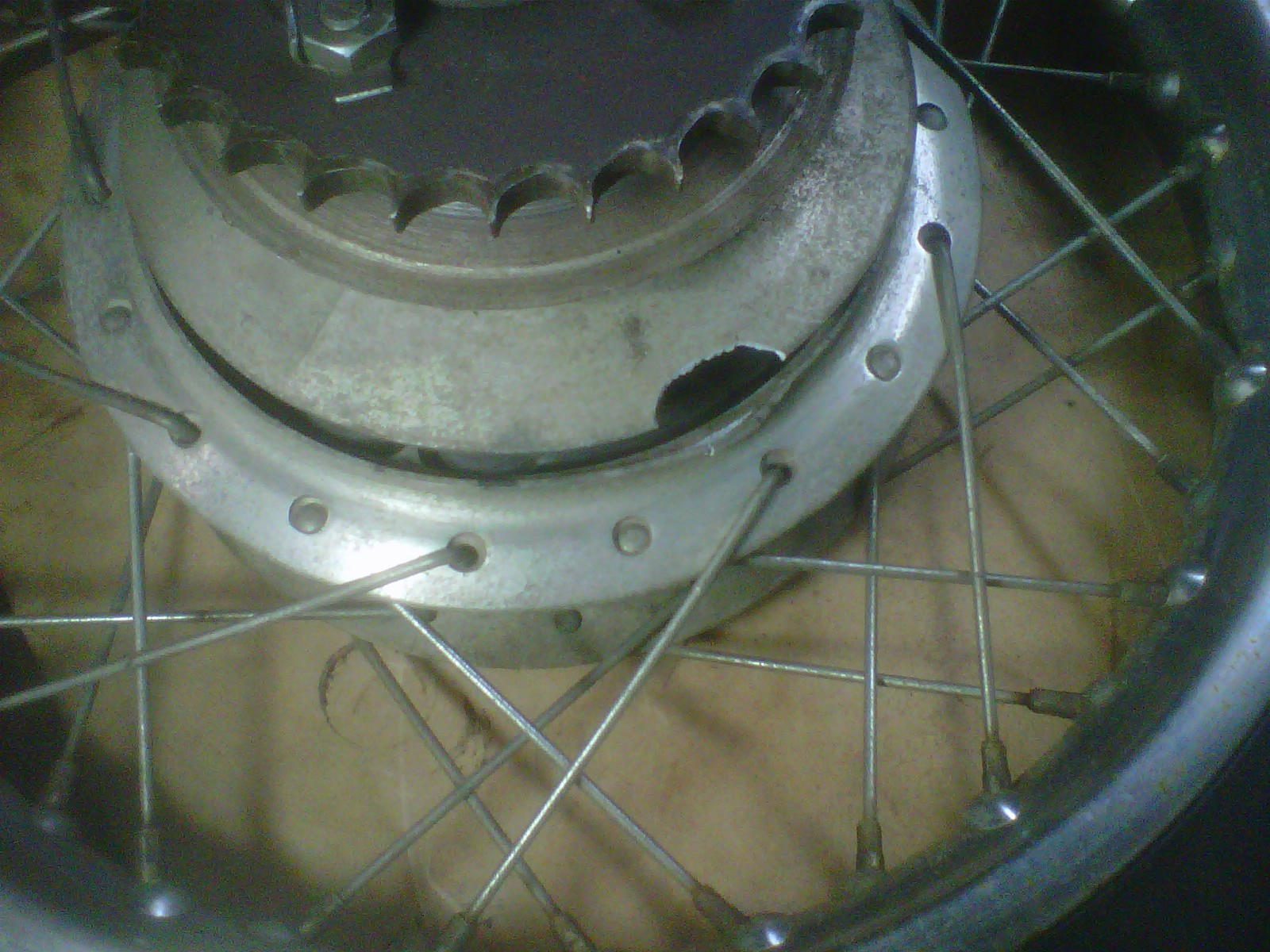

My whole rear wheel fell off my bench while I was working on it today and the below damage resulted. Just was wondering if this was fixable or am I looking at replacing the rear hub.
And before anyone asks yes I feel like an idiot.

I had the same thing happen, well sort of. I was polishing out my hubs and the polishing wheel grabbed the hub right out of my grip. It threw the hub a good distance in the garage. When I retrieved it, I saw a chunk like yours missing. I had someone "fix it". But, it broke again in the same spot. In the end, I paid for the fix, that didn't hold, and eventually I paid for a replacement hub. Just my two cents.

K ; that part is cheep and readily available. just get a good one. you also need a sprocket.

After I posted the topic I looked around to see what the part cost and I found both pieces for a good price so I went ahead and purchased them. The only concern I have now is taking the spokes off and putting them back on. Any guidance on this? I'm just worried about the alignment of the wheel.
