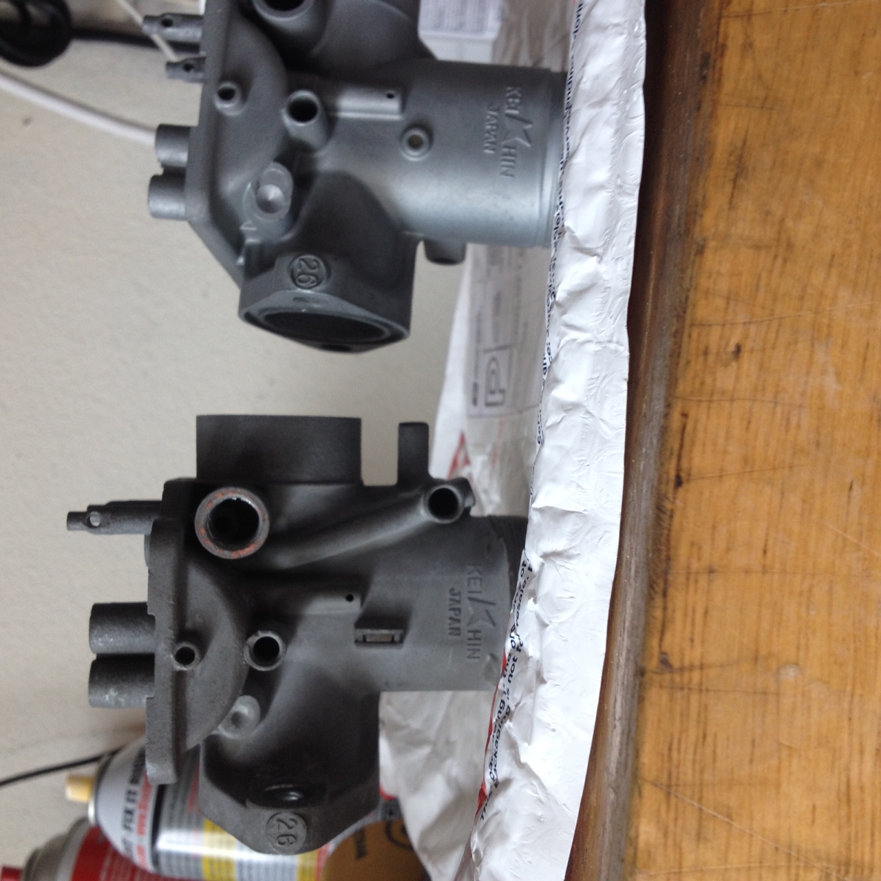

So, my slow return to idle issue ended up being the bike running on only the left right cylinder. It was further narrowed down to my left carburetor being faulty.
This replacement goes on tonight, and I'm crossing my fingers.
Old on the left, new on the right.
Thanks again, LM!
