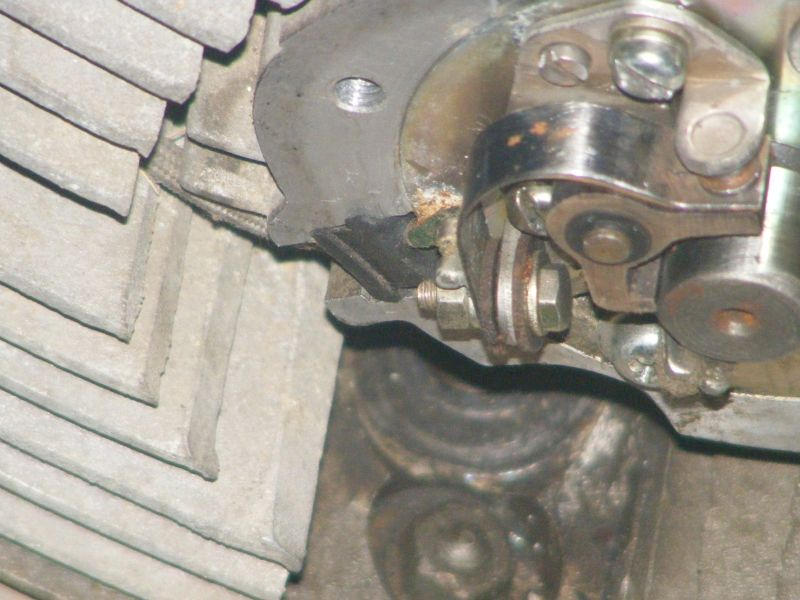

i unscrewed the bolt
Post by G-GAURD » Sat Jul 10, 2010 1:47 am
i unscrewed the bolt and found all the fibre washers and barrel i also cleaned the contacts and i still get power all the time open or closed now i have removed the horn so i can look at the condenser and it looks dirty and the the metal wire clamps are touching the head cooling fins so i'm gonna loosen it and roll it up to break contact.
i downloaded the infaview and i hope this picture will load up of my points so here goes
Post by brewsky » Sat Jul 10, 2010 3:58 am
Is the points wire contacting the plate where it bends to exit the cover?
Looks like some corrosion there.
