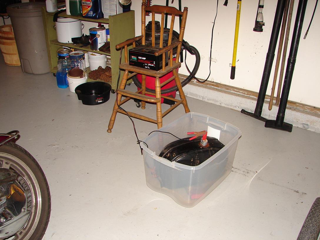

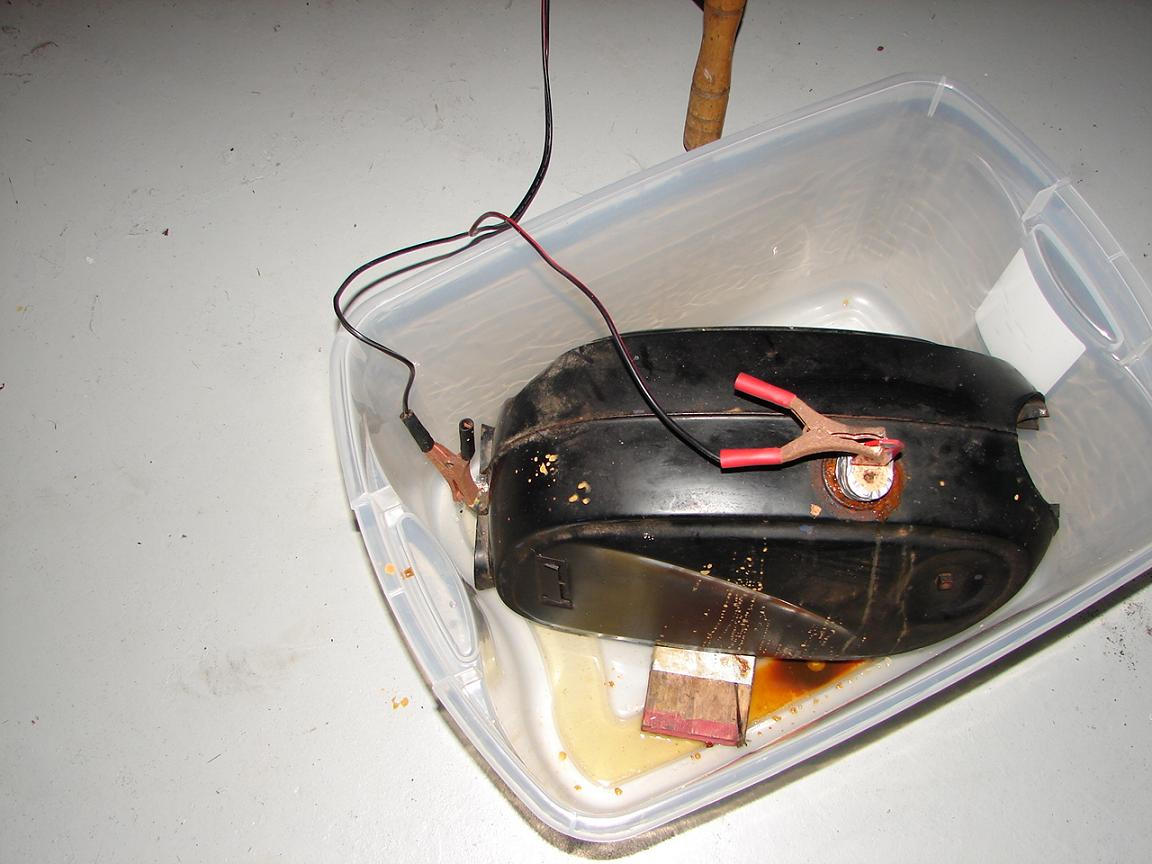

after conversing with sdaigle, thought I'd give the electrolysis rust removal a try. I had a badly dented tank, so that became the initial candidate. Seems to be working, although not quickly. If you light a match and hold it to the bubbles, you can hear a very faint pop sometimes. Another day or two should show what sort of results to expect. The tank was badly rusted inside, so I expect the results may take some time. I did not do any prep work such as shaking chain or BB's in the tank.

re: science fair project pics
Post by Mike Mullins » Tue Jun 02, 2009 8:01 pm
forgot to resize pics before trying to attach

When you finish, dry with compressed air. Then put a handful of small nuts in the tank and shake. Empty out and blow it out again. You will find it black inside because the rust converted to ??? cannot remember but the black surface will not rust again. Do not use any acids or sealers unless the tank has a leak.

Deaddog: thanks. I did not know what to expect. I have looked in the tank and noticed it was all black. I thought it wasnt working. NOW I know. I wont use the milkstone remover on this one.
