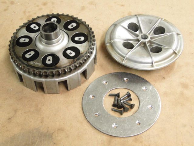

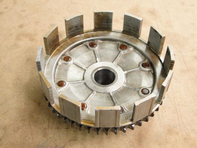

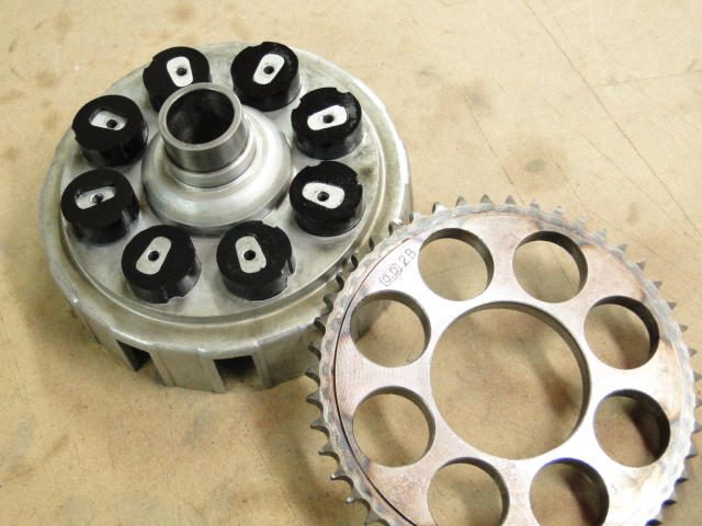

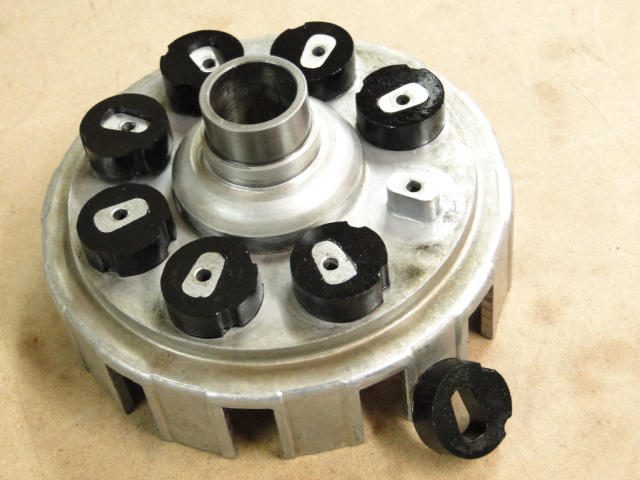

Took this clutch out of CB77E 108333 last year. The sprocket was a little wiggly on the outer so I replaced it. I was going to scrap it, but out of curiosity I drilled the rivets out and was a little surprised by what I found. By all appearances I would have said it was not a "cush" drive. Full of rubber donuts???
I replace one from my late 63 CA for the same reason and did the same thing ( just never got around to posting pictures) and it's exactly what you have there. The "Cush" which I replaced it with is different in other respects. Has anyone taken a "Cush" apart like this for a comparison of this part?
63 CA78

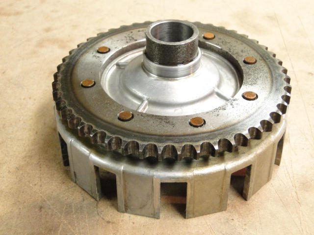

In hindsight, I don't think the little bit of rotational slop in that sprocket would have been a problem at all. Wondering if all the 250/305 clutches that look like this one are "cush-drives." I have another one that I believe is earlier and does not have the backing plate on the sprocket. The rivets are right on the sprocket itself and maybe that's a "hard drive." I'll post a picture of that one tonight.

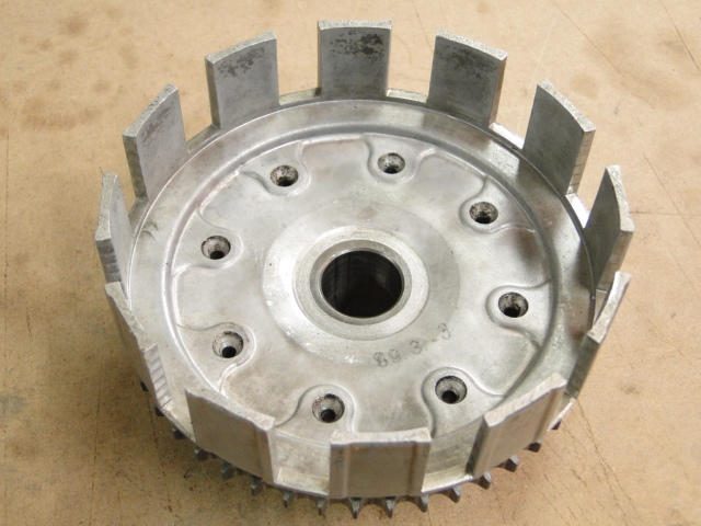

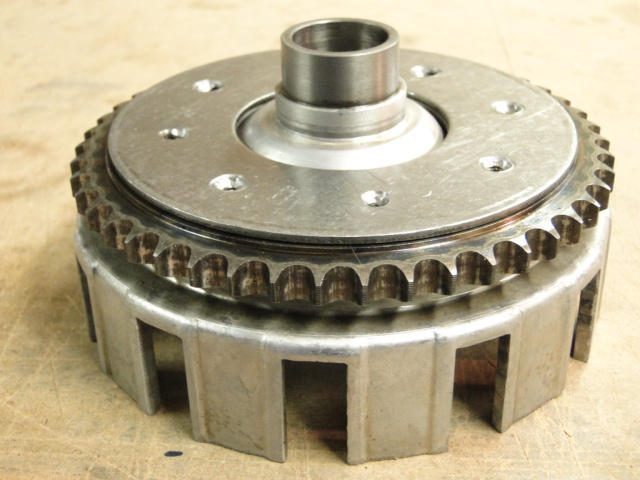

Here's the earlier clutch outer. Pretty sure no "cush" in there... This clutch was set up with 6 disks and worked fine. Sprocket is tight.
So, the common advice here has been to scrap these outers if the sprocket is a little loose. I guess I wouldn't now if it has a backing plate on the sprocket and the rivets are tight. Given this and OldStan's experience too, there's probably donuts in there and they probably just shrunk a little. Anybody need a sprocket?

The true one has a neoprene disk between the sprocket and aluminum hub. .........lm
