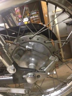

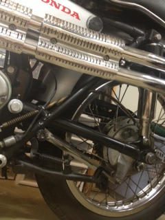

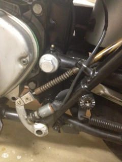

hope these images help! Sorry the images came out cock-eyed...oh well.
overall view
overall view
foot brake
foot brake
rear brake panel
rear brake panel
