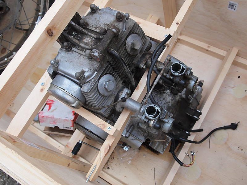

Rob
This is my CB160 motor and carbs as I shipped it back from the US. I don't think there is a bend in the Right Hand choke lever. It has to line up with the left one which is straight.
Cheers

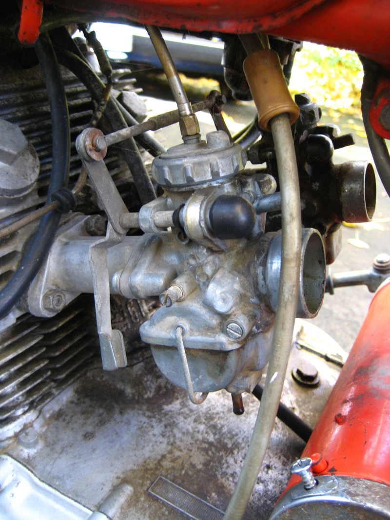

Two bent the same?
Post by Goodysnap » Sat Jul 07, 2012 9:49 am
How close is it to this one? I have no idea if it is an original bend, but like you stated, It sure heck looks like it.

Post by G-Man » Sat Jul 07, 2012 11:19 am
Rob
Here is another view of mine which is, I think, how it should look.

Post by Goodysnap » Sat Jul 07, 2012 11:30 am
After a reread of Rob's post I see it says bent toward the rear , as mine is bent toward the front. I'd say you'd be correct G. Looks as though we both got bent! Thanks for setting it straight.

Post by G-Man » Sat Jul 07, 2012 12:39 pm
Goody
Who knows for sure after 47 years? Being able to share info on the forum makes restoration a lot easier than it used to be,

Post by Snakeoil » Tue Jul 10, 2012 9:05 pm
Guys,
Thanks very much. I'm pretty sure that the top lever should be straight and not bent. All the pics provided have it straight up, not bent to the rear. The operating lever on mine is also dead straight, so I'd say that those that are bent either forward or aft are not as they left the factory. I could see those getting bent easily since they are in a better position to be snagged.
I'm going to straighten mine based on this.
Thanks and regards,
