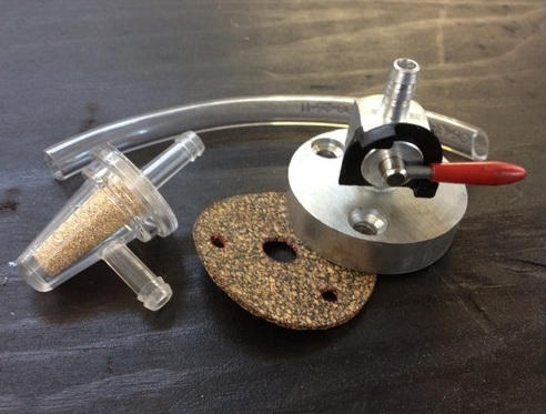

My product provides a good solution:
http://www.ebay.com/itm/271018122754
