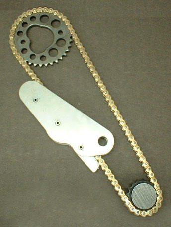

why not adapt this tensioner design , this one is for a cb 750 (four)
and a similar tensioner exists for the CB350 (twin)
it is interesting to know that the cam chain is the same for the 305, the 350 cb & 750 cb and with the same number of links !!!
friendly MK
