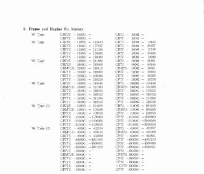

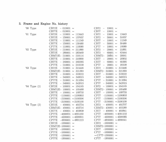

Re: Mfg Date by S/N#
Here's a screen shot from a parts manual. I have no information beyond this.
