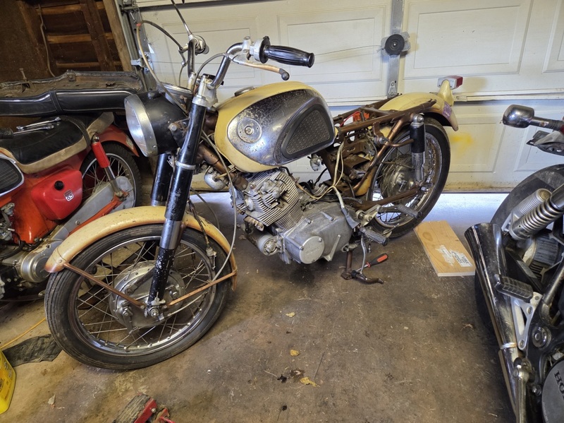

my rust-oration of a 1965 CB77 is going along nicely, and i am beginning to check out my wiring situation. its hit and miss.
i believe i can use most of what is there, even if the wires are incredibly stiff. unfortunately, some of the bullet connectors have broken off.
theres a site called vintage connections that ive used for years, they have all the 3.5mm bullet connectors youd want for a later honda, but they dont carry the type used in the 60s. (i dont know what they measure, but its smaller by a little.)
does anyone know if theres a place that does carry those smaller bullet connectors or something that will work? i would like to try to keep everything original if i can, but i will replace things with modern parts if i have to... its just that if i have to replace only ONE connector with a 3.5mm modern one, its going to drive me nuts and i will want to replace them all, which means the whole harness, which is stupid and wasteful and shouldnt be done, and so you see my dilemma here...
