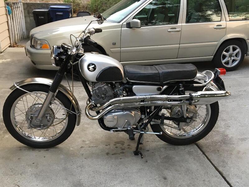

Much of the charm of a CL72 is in its original configuration; e.g., Small brakes, Steel front forks, Alloy fenders, high straight through pipes w/baffles. A Large Brake conversion will require alloy front forks, a six-hole front fender stay and steel fender, cables and fittings for the big brake setup.
Big brakes (borrowed from the CB450) are great for a CL77 (photo)
But as Michael says, don't be in a rush!
