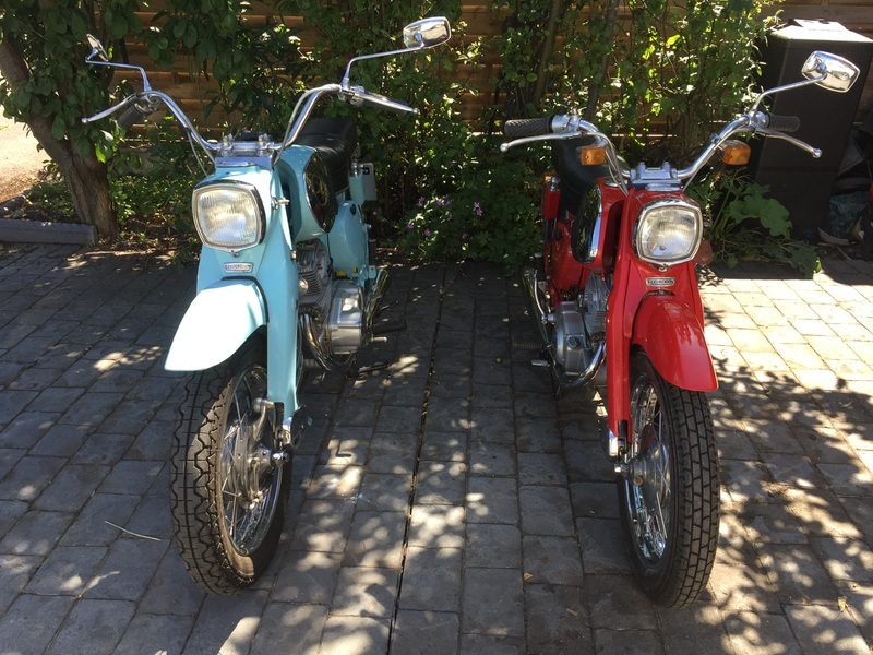

Sorry I should have said, I have a CA77 and a C95 and measured the headlights on both. C95 is 140mm and the CA77 is 150mm, this is measured across the outer chrome rim.
