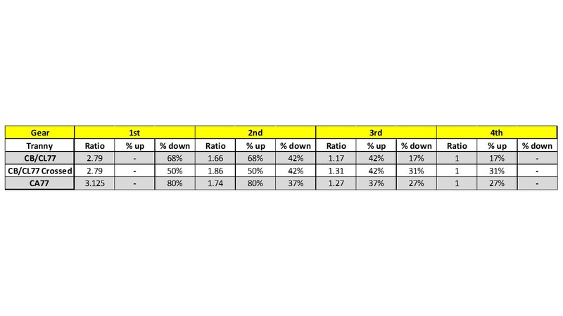

Using a CA gearset in my CL was an option at one point. One of the guys over on the S90 group said he did that for his CL because it best suited his riding style. I looked at the 3 options, std., crossed and CA and decided the crossed ratios were best for me. If there was going to be a road racer, I think the CA would be the better choice because it gives you a close ratio gearbox in the top 3 gears.
Here is a table I put together showing the 3 options for gearing. Granted there are other options if you want to take CA gears and use them in the CB/CL tranny. But for my purposes, these 3 choices were all I considered when I started down this path.
