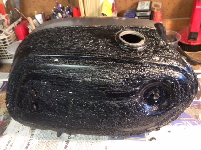

Post by Seadog » Thu Jan 09, 2020 6:47 pm
It bubbled the paint up on this tank when others failed

Post by Tim Allman » Fri Jan 10, 2020 10:02 am
It looks like a methylene chloride based stripper. There are multiple brands but in my experience they are all the same and work well on these baked-on factory finishes.
