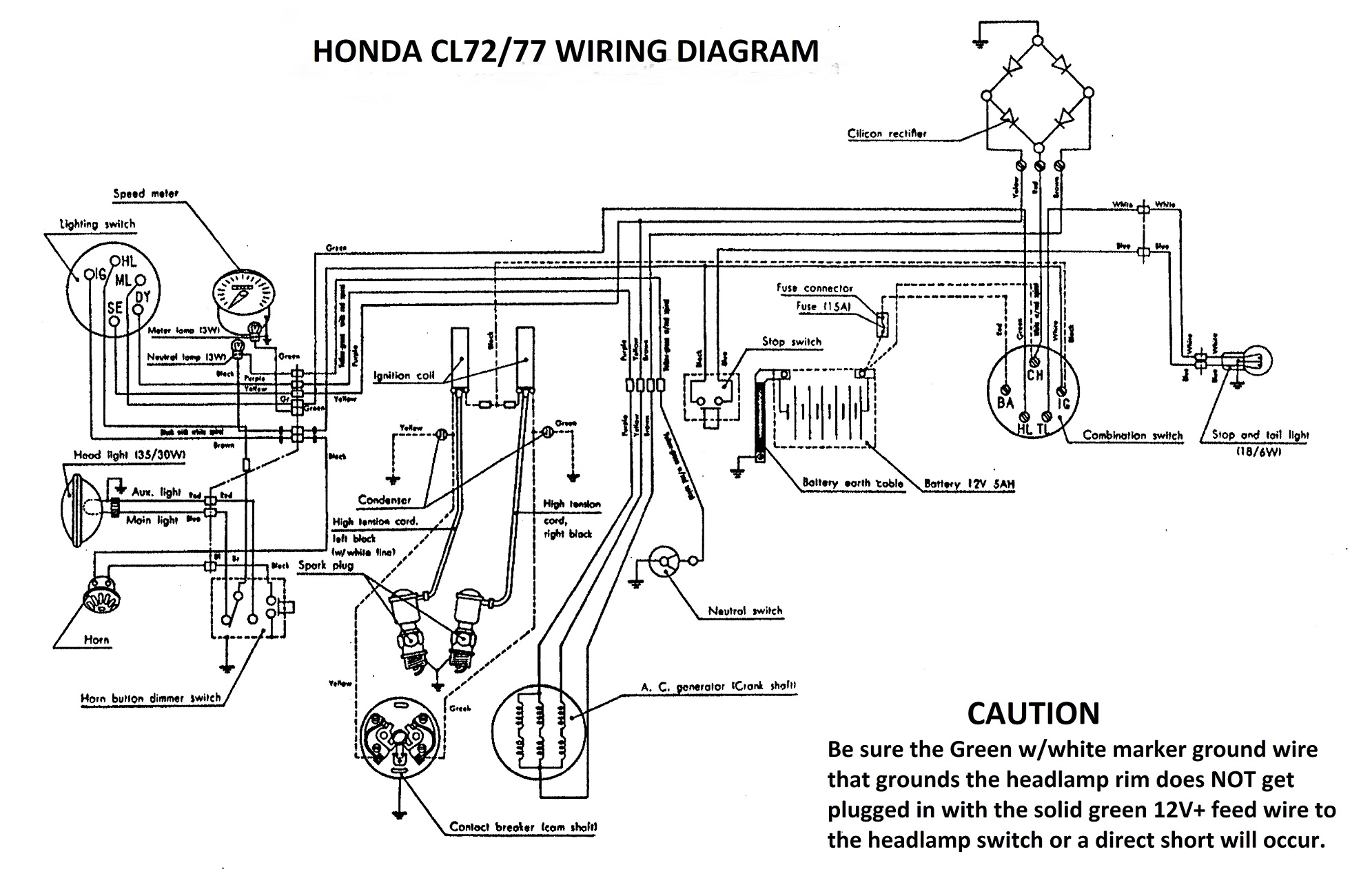

Thought maybe this CL77 specific diagram might be of some use.

I can provide a much clearer 2 MB copy through E-mail. ...I can't post the high resolution photo on this site.

It's interesting that this diagram labels the rectifier as Cilicon Rectifier (silicon misspelled of course) rather than selenium rectifier. If this is in fact the case then a CL rectifier should be the replacement of choice silicon has less resistance and does not go off with age so much.

I think you are correct. From memory the CL72 Shop Manual states that the CL has a silicon rectifier too and goes on to highlight the improvements over the 'old' selenium device.
Strange though that Honda equipped the CL models with a supposed superior silicon rectifier from 1962 but carried on fitting the inferior selenium devices on the CB models for another five years; or did they just upgrade those too and not bother to tell anyone?
Anyone know?

my 1967 model had the selenium rectifier. had to upgrade it when I restored the bike.
