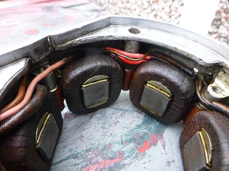

I noticed that there was no charge at all, tested out the stator only to find open curcuits & dead shorts on others, Bugger.
Checked on line, only to find junk, then found someone who could do a re-wind for around £190.00, just about to commit, when I thought, 'what have I to lose if I pull it apart, no apparent burning anywhere, so apart she came.

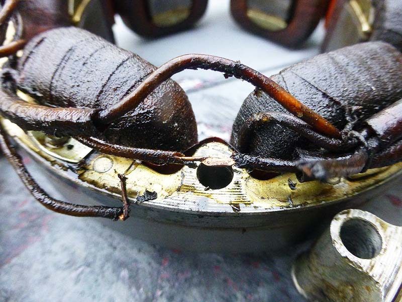

WOW, some numpty in a previous live had obviously been there before me, heavy gouging from being over-gripped in a vice, & as it came away, the alloy cast-ring fell in two!!
A closer look reveled one inter-coil wire broken & a second actually trapped between the alloy ring & the stator core, so tight that the insulation was gone & the copper wire was flattened out, so not only was it stripped very badly, it was re-assembled even worse!!
Carefully pulled apart, wires cleaned,fluxed & re-soldered, new local insulation, & I at last have NO shorts to ground & equal resistance between the output wires!!
Re-fitted to the bike & luckily for me, the tight fit into the cases keeps it together, & it still checks out ok, not charging the battery yet, but one down, a few more to go!!

- Stator2.jpg (94.01 KiB) Viewed 3504 times
- One broken & one trapped
- Stator1.jpg (97.16 KiB) Viewed 3504 times
