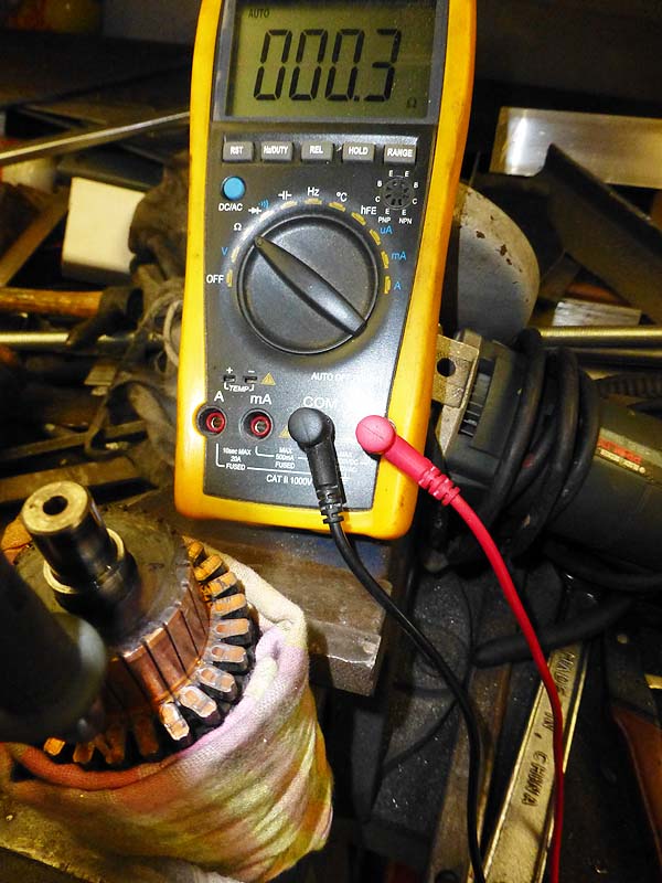

The starter however is 'lazy', so I removed it, hooked it up to a big battery & she spun like a good-un, then it didn't, then it did!! EH!!
Stripped it down & the brushes & commutator look new, completely smooth, no scratches or marks, a good deep undercuts, brushes also look new, long & clean.
Got the meter out & started to check continuity etc. but can not find any meaning, as some segments have continuity, others do not, also, only 2 carbon brushes & they are at 90 degrees & not 180, so is the construction of these motors arranged different to the norm??
I need an electrical expert to tell me correct way to check these out, physically the motor is as new, I suspect by the way it runs intermittently, that there must be a armature breakdown somewhere, but how to check, do I meter adjacent segments, every other, one to all or what??

I just pulled one of mine apart and did a continuity check. All the segments read 0.1 ohm to each other, ie I put one probe on the first segment and then got the same reading all the way round. I then popped it back together just to check nothing had gone amiss while sitting on the shelf and it still functioned fine. Just to clarify, I touched the first and second segments, got 0.1ohm, then the first and third segment and so on all the way round.I then did random segments with the same result. The point one of an ohm is just what the Meter reads with the two probes touched together so is not an actual value for the windings, might need a new battery in my meter.
