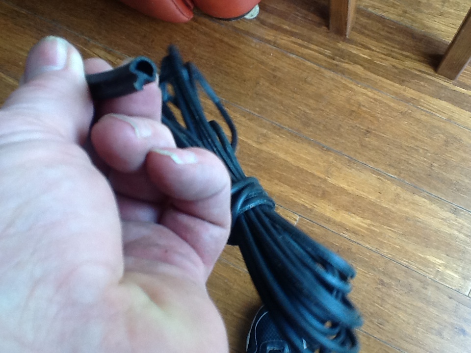

cadman wrote:What's everyone using for the black trim around the side covers?
This is what I used, it's actually a rubber gasket that is used on aluminium window frames, on the panel with the recess it just pushes in and on the side that usually has the two rubber pads I glued it in position. So, just ask a glazing installer, it cost next to nothing.
