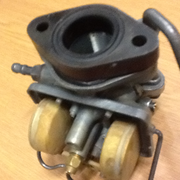

I've just been investigating the general lack of get up and with my CA77 and found the inlet insulator is too small, it does not cover the o-ring properly. I looked at a couple on eBay and they have a semi circular groove, does anyone know the purpose of this groove?

I appreciate the sentiment but the only original ones I've seen are in the states at about £30 including postage so thought a generic fibre insulator of the same dimensions for £5 would be preferable. Also, I do like to know why particular design is used.

Whatever insulator you end up using, better check it for flatness. Had mine off a while back and discovered that it was warped.

Thanks Nick, always worth checking including the carb flange for distortion. I've had a closer look at the pictures on eBay and it would appear that there is also a tiny hole drilled in the insulator, does this hole connect to the semi circular groove?

You really need to get the correct part for your carb if you want it to run correctly. The differences probably affect only the slow running circuit.

If it's to much money to get the proper part then why not just bolt the carb direct to the head!. .............lm
