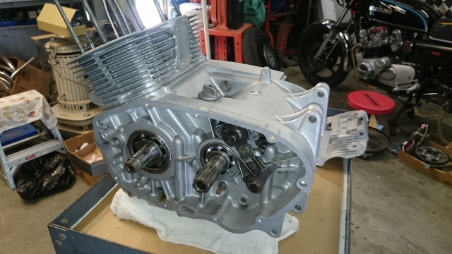

Thanks DJM, I am doing a new build. The chain tensioner is out, I am not quite convinced that torqueng the head down is gonna give me enough length. The gaskets are aftermarket of some unknown brand. I feel like even if I could get it together it would be under (maybe to much) tension. Here's a pic. [/img]

Post by LOUD MOUSE » Sun Aug 06, 2017 6:06 pm
I recommend you do as suggested.
That chain at 94 links will be the same as others and it IS NEW and NOT STRETCHED.
The new gaskets (2) need to be compressed a bit and then consider that the open link has to GO OVER a tooth to install. ......................lm

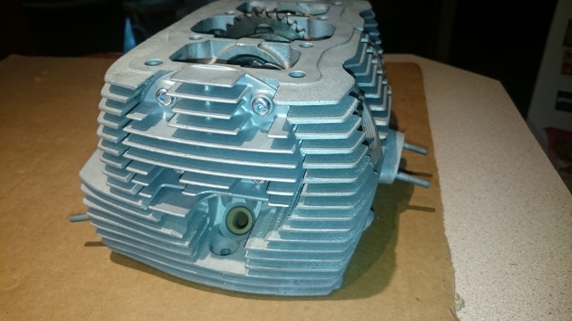

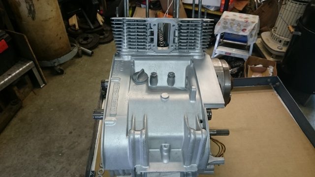

Thanks LM for your input. I thought I shouldn't compress the head gasket, loosen it & re tighten it. A couple more pics

Post by LOUD MOUSE » Sun Aug 06, 2017 7:12 pm
I know of no reason you need to compress then loosen.
In the 60's we installed rings/had valve work/ and replaced the beoprene then used the same head gasket.
Your parts look nice.
Hid you have the head and cylinder surfaces broched/flattened?. .............lm
