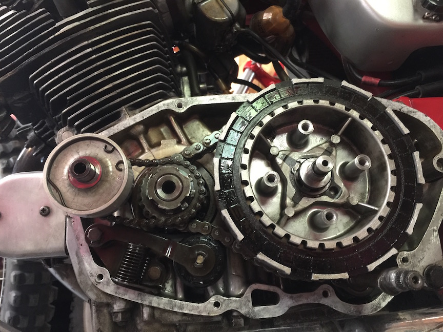

OK, I took a better look. see IMG_2501.
I reversed the circlip holding the clutch onto the transmission mainshaft, in case it was "dished" causing axial play. There was still some play.
I also adjusted the cam chain tensioner.
The rattle is now diminished, but I believe it may have to do with tightening the clamps holding my muffler to the header pipe.
Oh well, I needed an oil change. The filter was spotless after 1000 miles, by the way. I never seem to see the vast accumulation of muck that others report, perhaps I slip the clutch less? More likely, my clutch disks are so old there they shed less material.

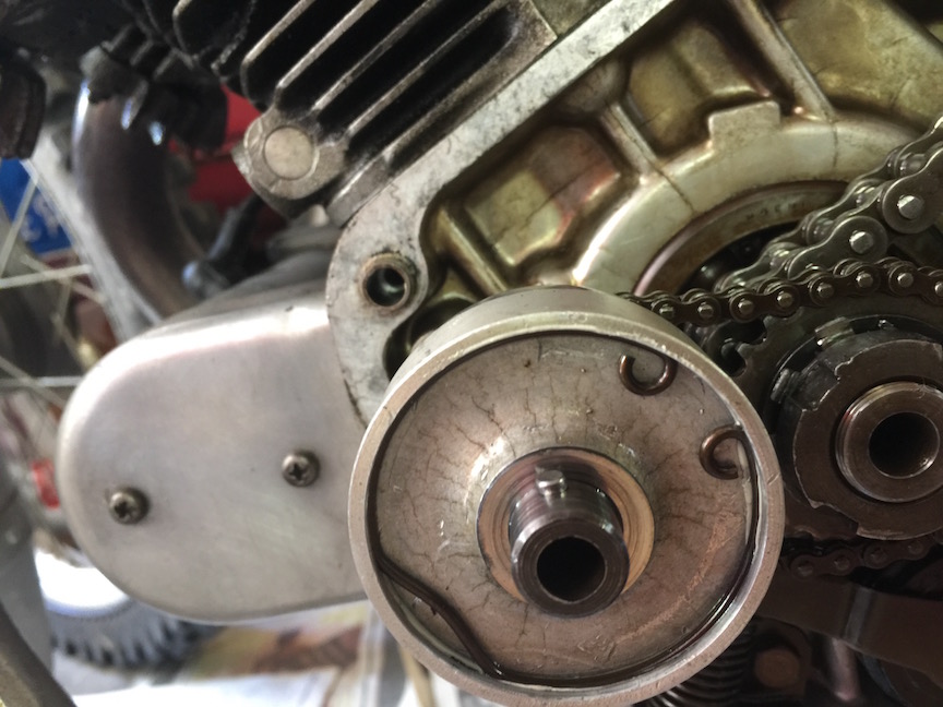

Important Side Cover Note: See IMG_2503, the locating pin on the oil filter tube must be pointed up, or it does not fit the corresponding groove in the side cover and bad things will happen when you tighten the sidecover screws.

- Two of many chains in a CB77 engine.
- IMG_2501.jpg (122.18 KiB) Viewed 2474 times
- Note locating pin must be vertical to install the sidecover
- IMG_2503.jpg (87.17 KiB) Viewed 2474 times
